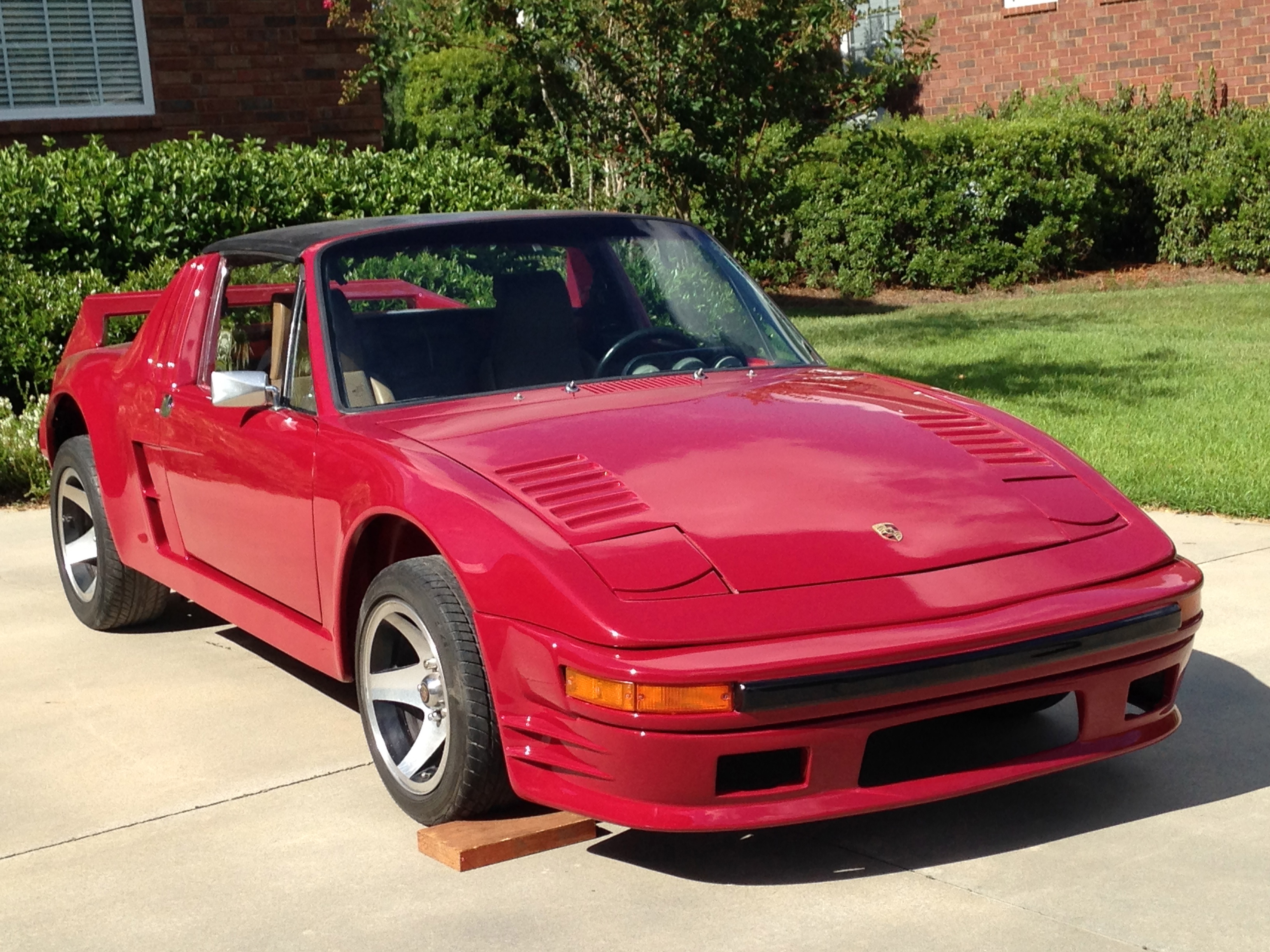

Here's Malaga red for you: I think I'll loose the spoiler however.
