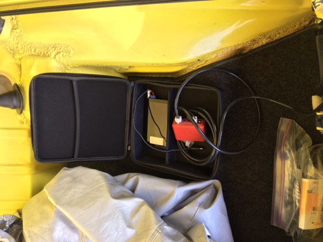

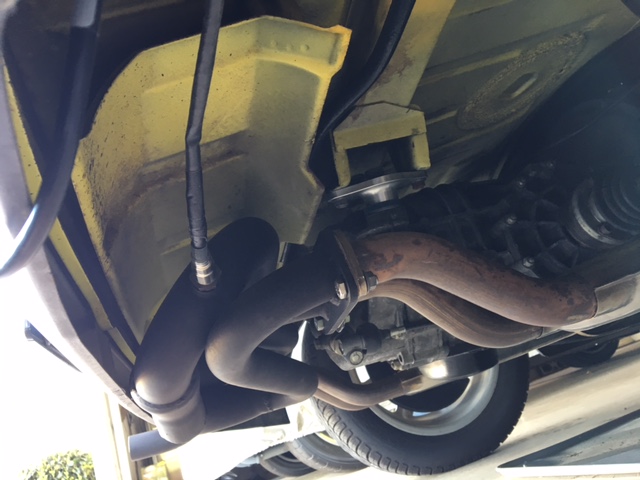

Here is my O2 sensor and PLX installation.
