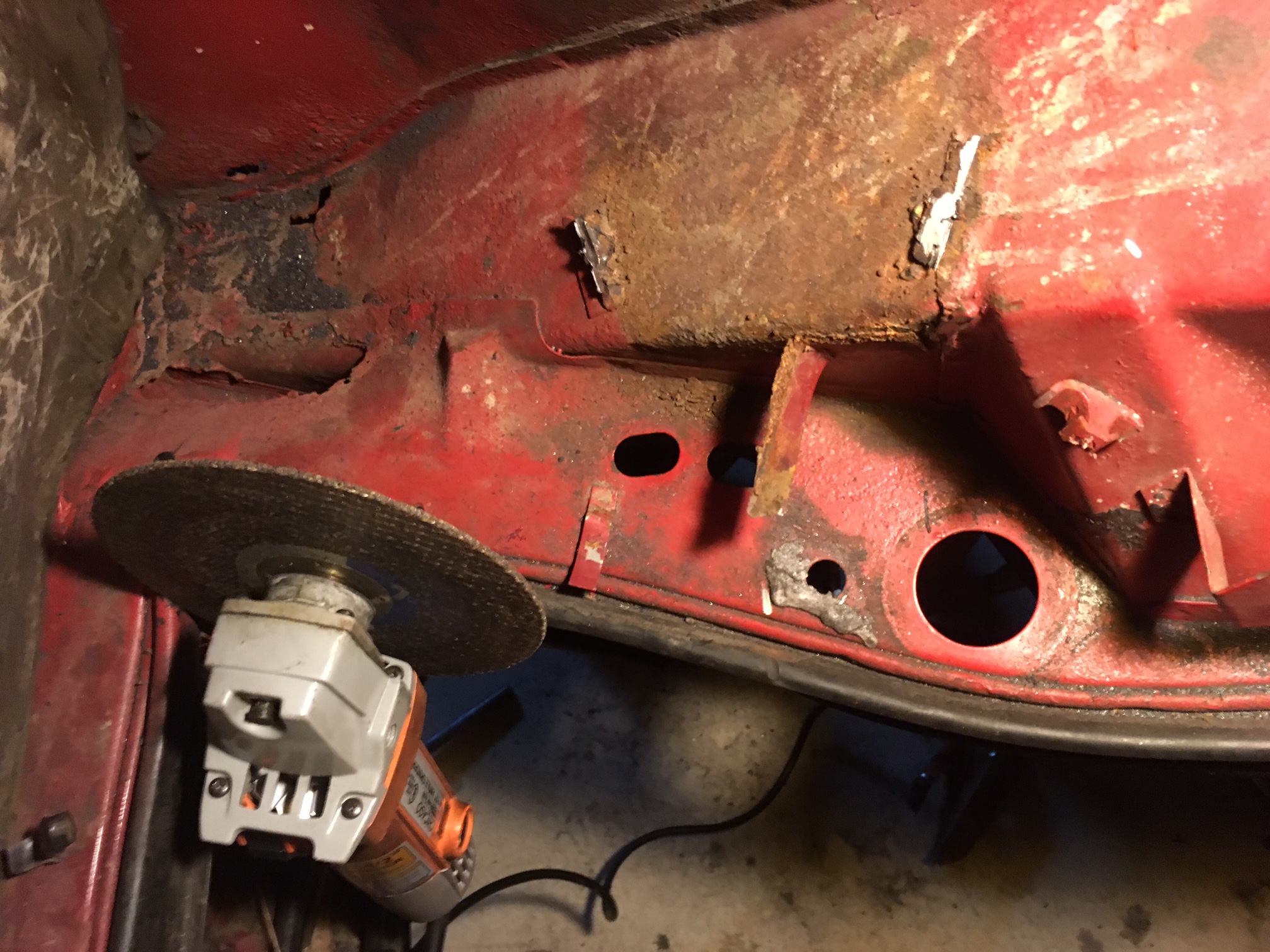

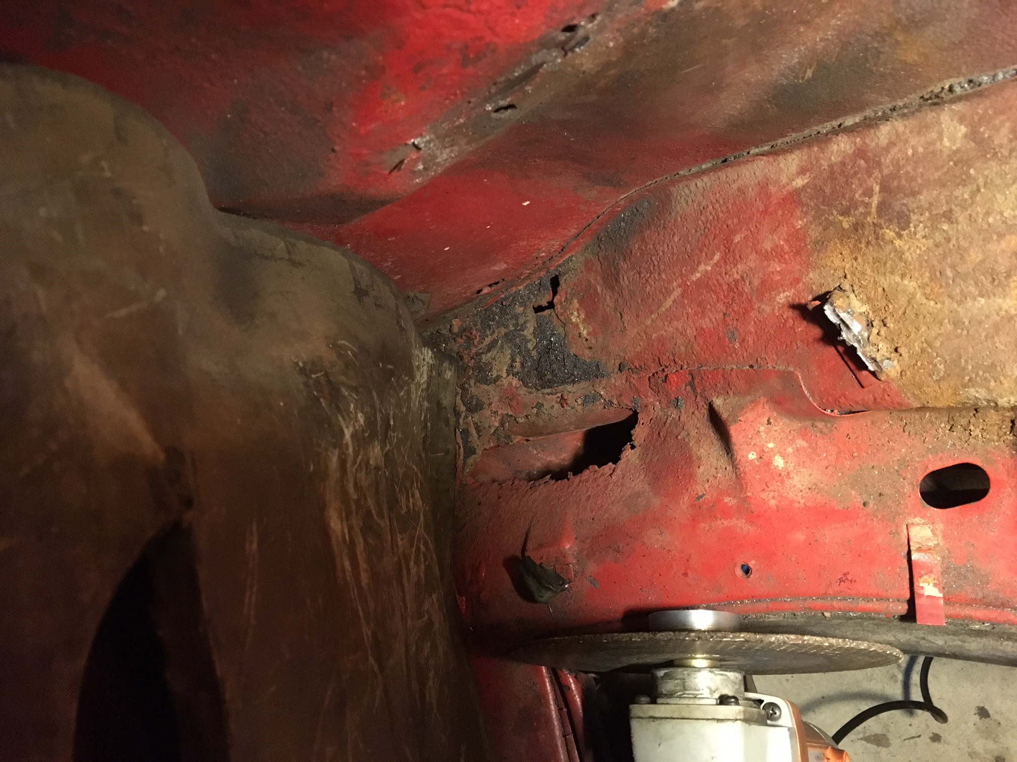

Cut out the battery tray and stand today. Someone previously put in a new tray and stand but did not repair the rust down below. I've got new sheet metal on the way from restoration design. Say what you want about HF tools...I've been using this harbor freight grinder for about 6 years now.

mtndawg   Cut out the battery tray and stand today. Someone ...   Mar 8 2017, 09:51 PM
mtndawg   Cut out the sheet metal. I was using a cutting whe...   Jun 23 2017, 06:28 PM
mtndawg   I also discovered there are 2 layers of sheet meta...   Jun 23 2017, 06:31 PM
