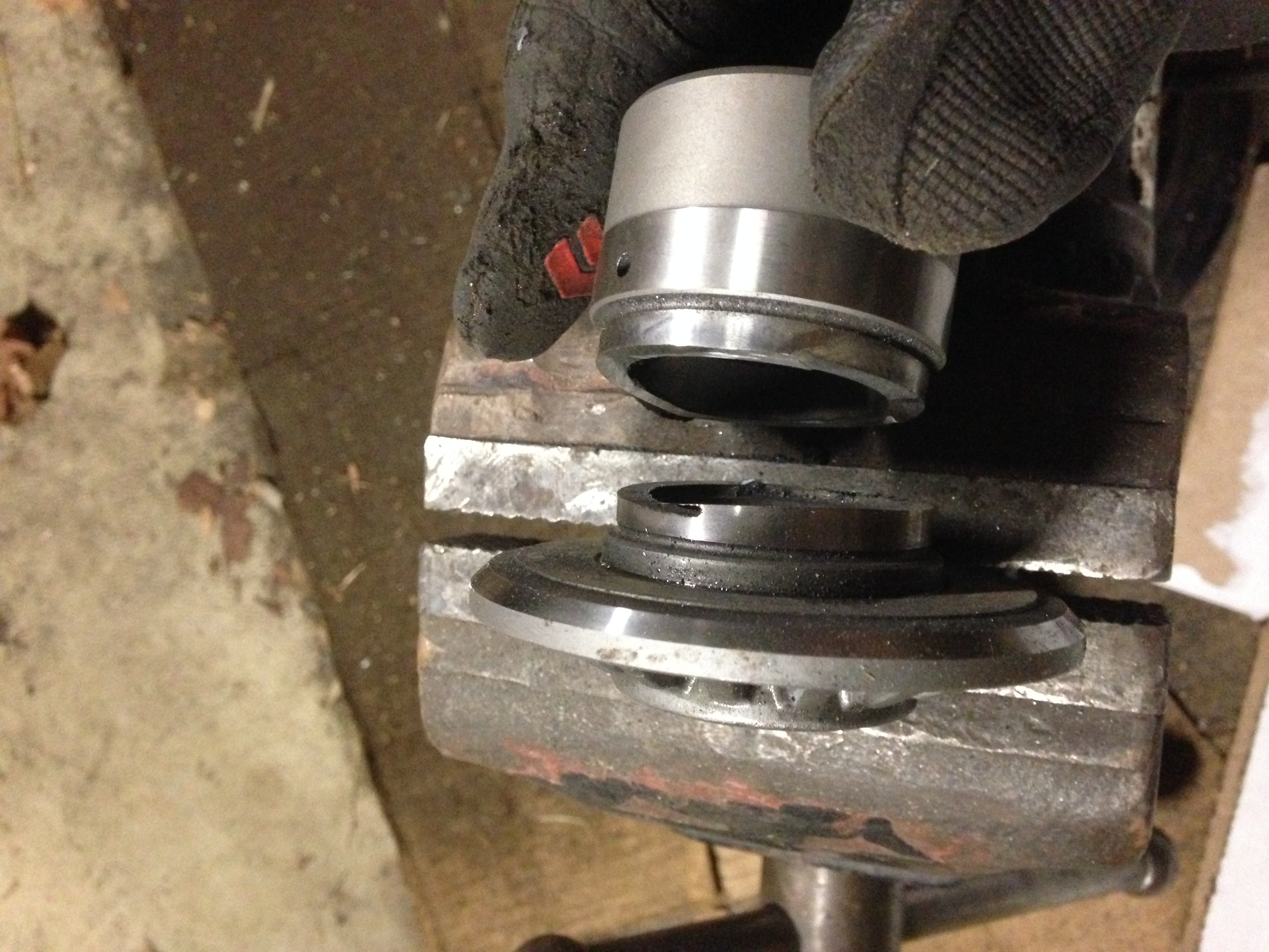

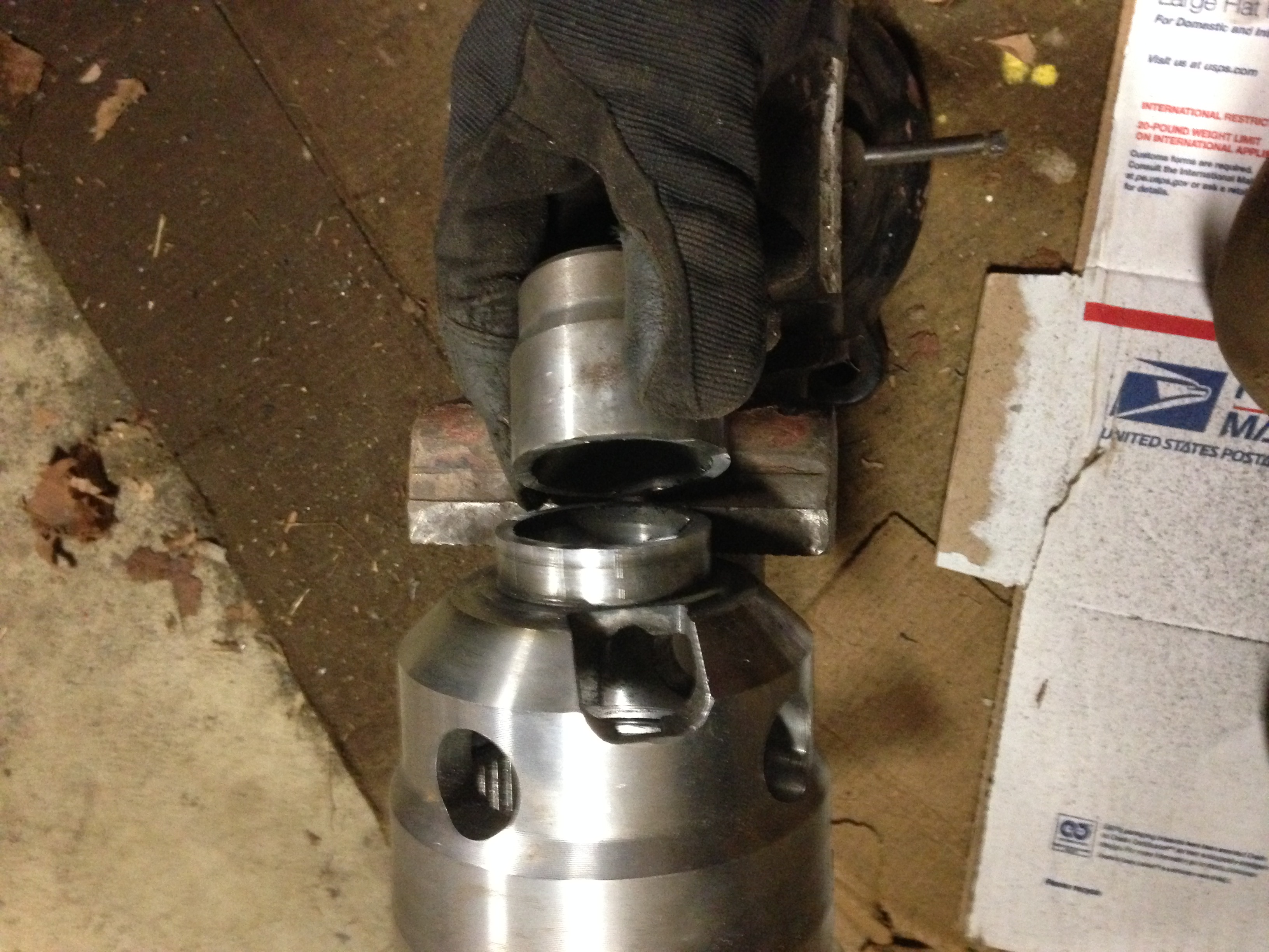

Cut up the differential last night and test fit in the transmission. I'm making the 2WD lockout in the same way that 914pipe and jpnovak did by welding the input/output splines on the center differential together.
jpnovak: http://www.914world.com/bbs2/index.php?showtopic=104513
914pipe: http://www.914world.com/bbs2/index.php?sho...p;#entry2419604
My splined pieces look are identical to those of 914pipe; jpnovak had a second, smaller splined section in the middle of his spider section.
The guy who owned this thing before me removed the big carrier bearing before selling it to me. I didn't notice at that time (or even really until I tried to slide the thing into my transmission), but he used a BFH to remove the bearing rather than a press and damaged the front edges of a bunch of splines on one side. It took about 30 minutes with some thread files to fix the leading edges and get it slid into the diff.
First step is to cut the splines off of the outer casing and spider gear. I cut a bit long on the spider since I wanted to protect the nut/transmission from spatter while tack welding.
