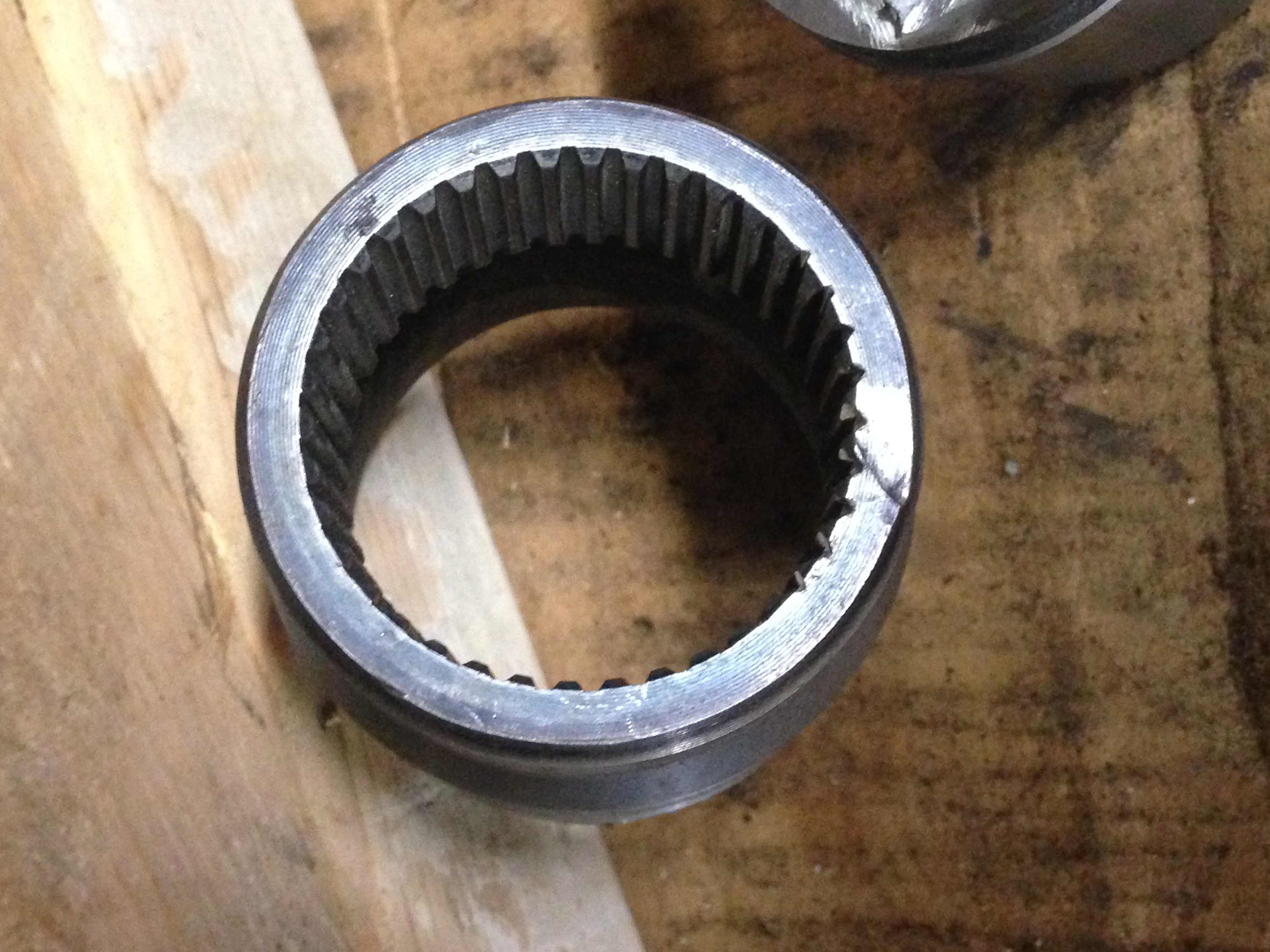

post Mar 10 2017, 09:57 AM
Its alive
Posts: 4,891
Joined: 16-February 04
From: CT
Member No.: 1,659
Crudely filed housing splines. You can see where it was hit with a hammer. (IMG:style_emoticons/default/wacko.gif)
Next the two pieces were deburred and fit into the transmission. After making sure they were seated I threw on a few tacks with the MIG to hold everything in place. The structural welds will be TIG.

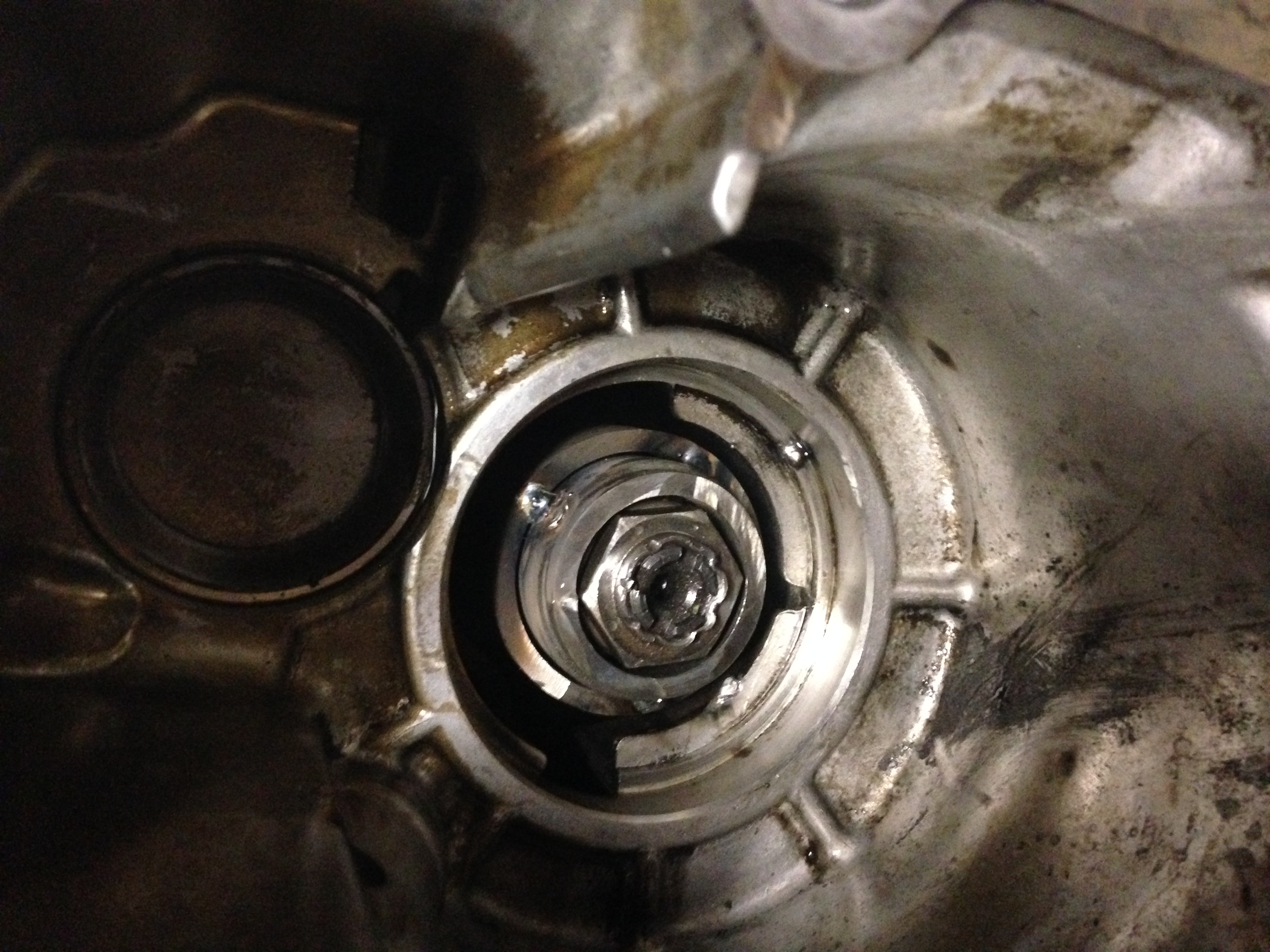

jd74914   Pulled apart bad center diff ready for cutting.   Mar 1 2017, 12:54 PM
jd74914   Cut up the differential last night and test fit in...   Mar 10 2017, 09:53 AM
jd74914   Crudely filed housing splines. You can see where i...   Mar 10 2017, 09:57 AM
jd74914   Of course it wouldn't slide out of the differe...   Mar 10 2017, 10:04 AM
