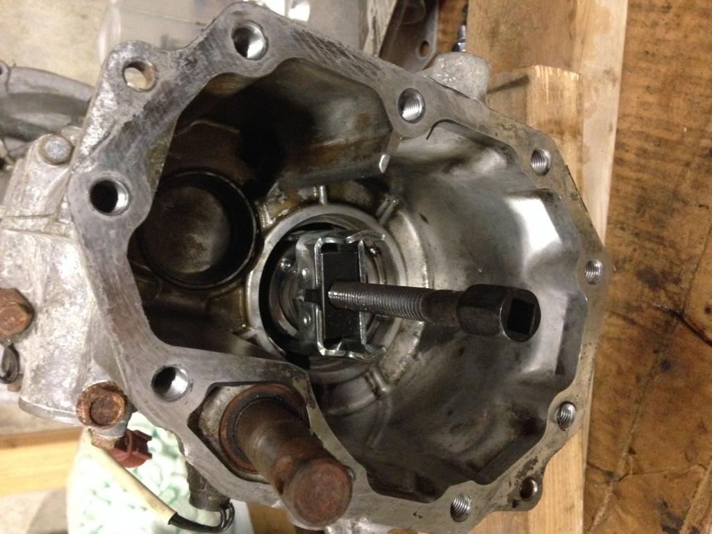

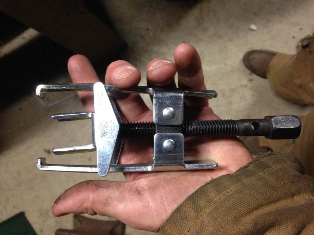

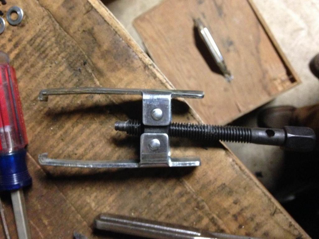

Of course it wouldn't slide out of the differential nicely by hand or even with some picks. Conveniently, Subaru left some access slots for a narrow puller. It turned out to be just enough room for a cheap generic valve spring compressor to fit. I just had to sand about 0.050" off one of the puller edges and remove the spring centering piece and it fit in like a charm.

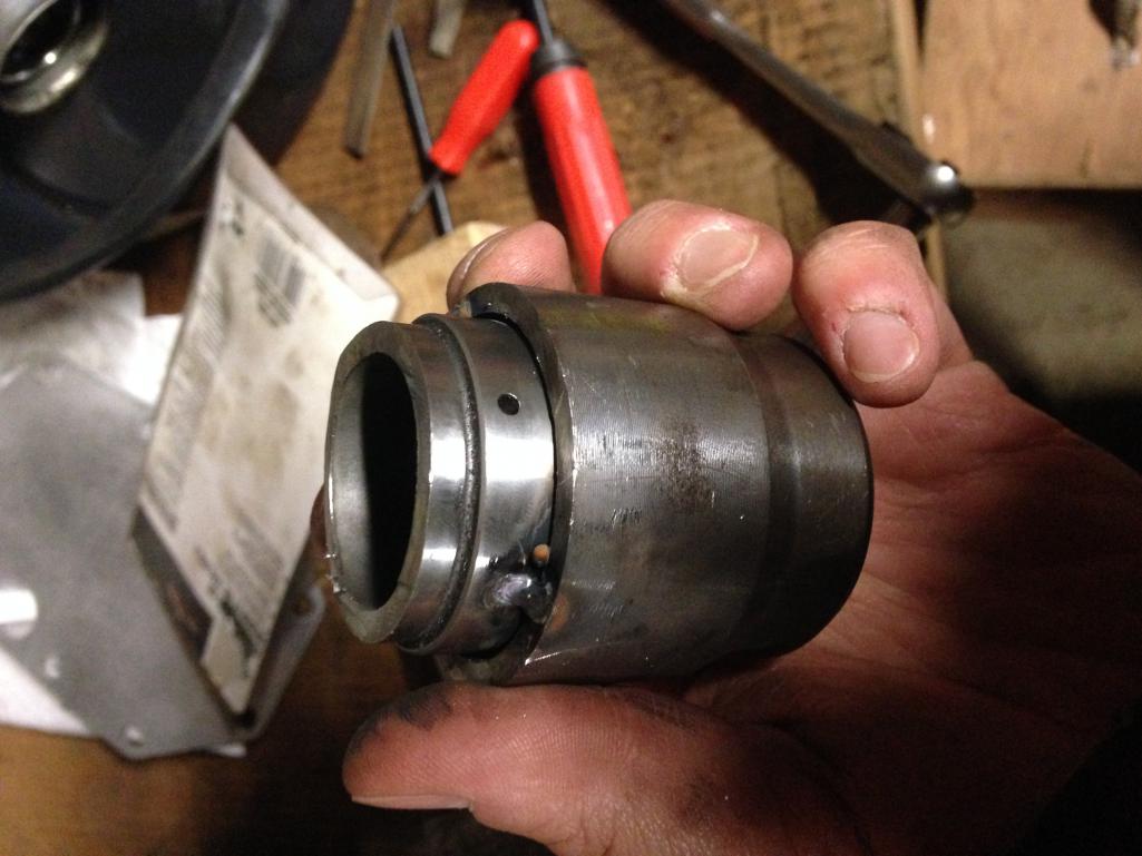

Locker pulled out. I'm going to put a few more solid tacks on the outside after turning a quick insert to keep everything concentric. After the outside is a bit stronger the plan is to TIG up the inside, turn it to the correct length to fit the nut and washer on (about the currently length of the outer piece), and full weld the outside with the insert in place to keep everything straight. Then hopefully it all fits together! That would complete the internal transmission stuff for now. (IMG:style_emoticons/default/smile.gif)
