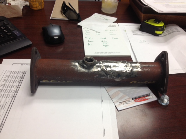

I do like welding stuff.... but man you can screw things up in a hurry.
Here is the result of my BUNG HOLE (IMG:style_emoticons/default/piratenanner.gif) (IMG:style_emoticons/default/piratenanner.gif) welding.
It took 3 bungs and some patching of the areas I screwed up, but I am not too proud to show the world.
Point of interest here. I did not really screw up on the welding of the bung to the pipe. I saw a YouTuber that installed the plug that is supplied with the bung. He then welded. His thought was to keep spatter off of the inner threads.... makes sense to me.
Well the bung gets hot and ends up galling up the plug so you can't get it out.
I ended up covering the hole with a small bolt dropped in the bung and a large washer.
Repairs are complete, I'll add some Hi Temp paint to hide my grinding work and start working on where the wiring goes this weekend. Good garage day, it is supposed to snow in Nashville. (IMG:style_emoticons/default/WTF.gif)

Mark Henry   Was your wire feed sticking? You likely need a new...   Mar 10 2017, 03:04 PM
malcolm2   Was your wire feed sticking? You likely need a ne...   Mar 10 2017, 03:10 PM
