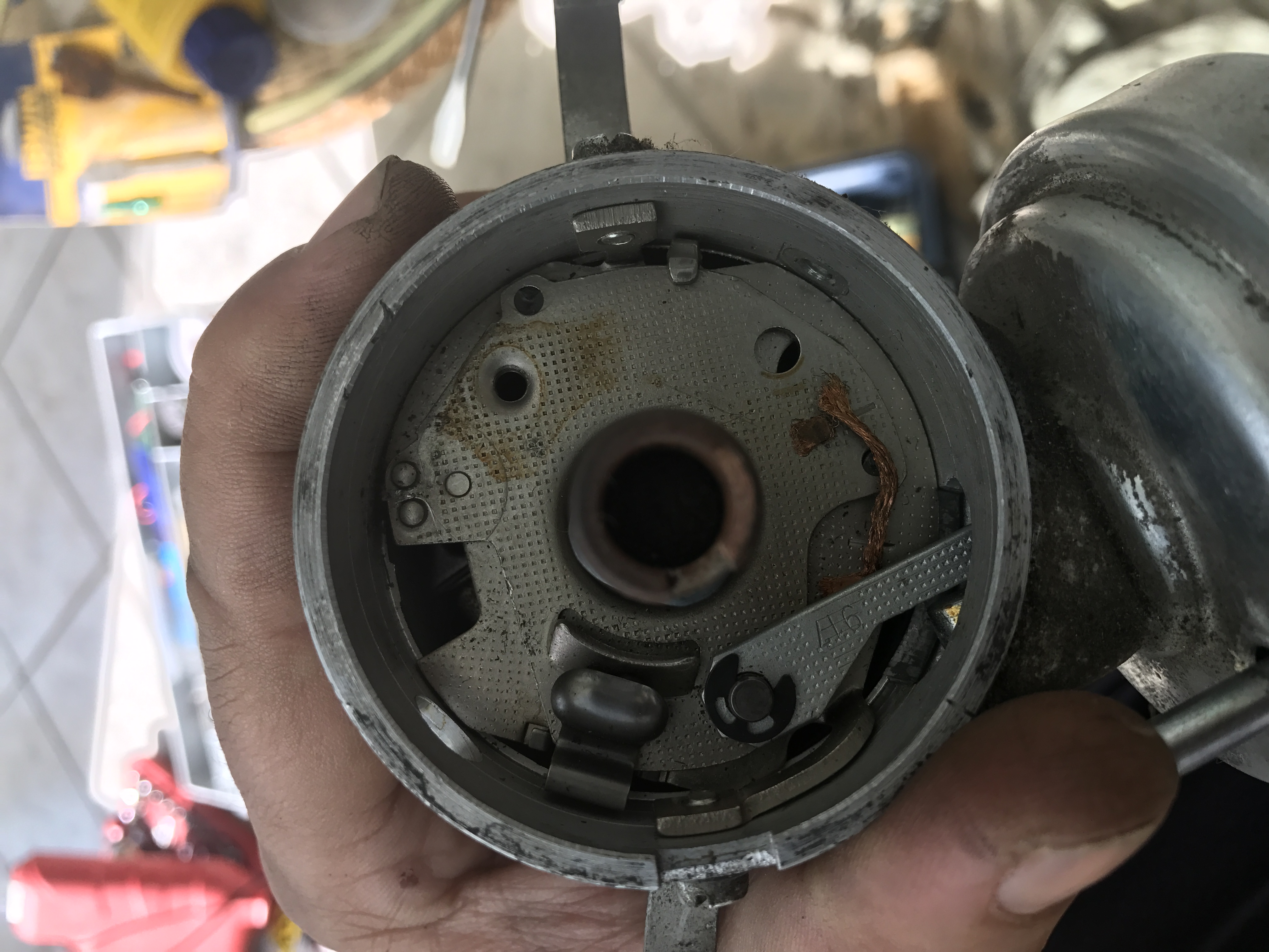

DD I really appreciate your help. So what I did today. Reinstalled the the manifold after perssure testing. Then pulled the distributor after realizing I needed to set it for 3500 rpm not 3000 and because I need to fix the cable in it so I did that redid all my timing steps and now I'm at 1900 rpm consistently. I can turn the distributed and bring the rpms down but I start to get back firing as I do. I did however drive it around the block. So it was nice to drive it around.

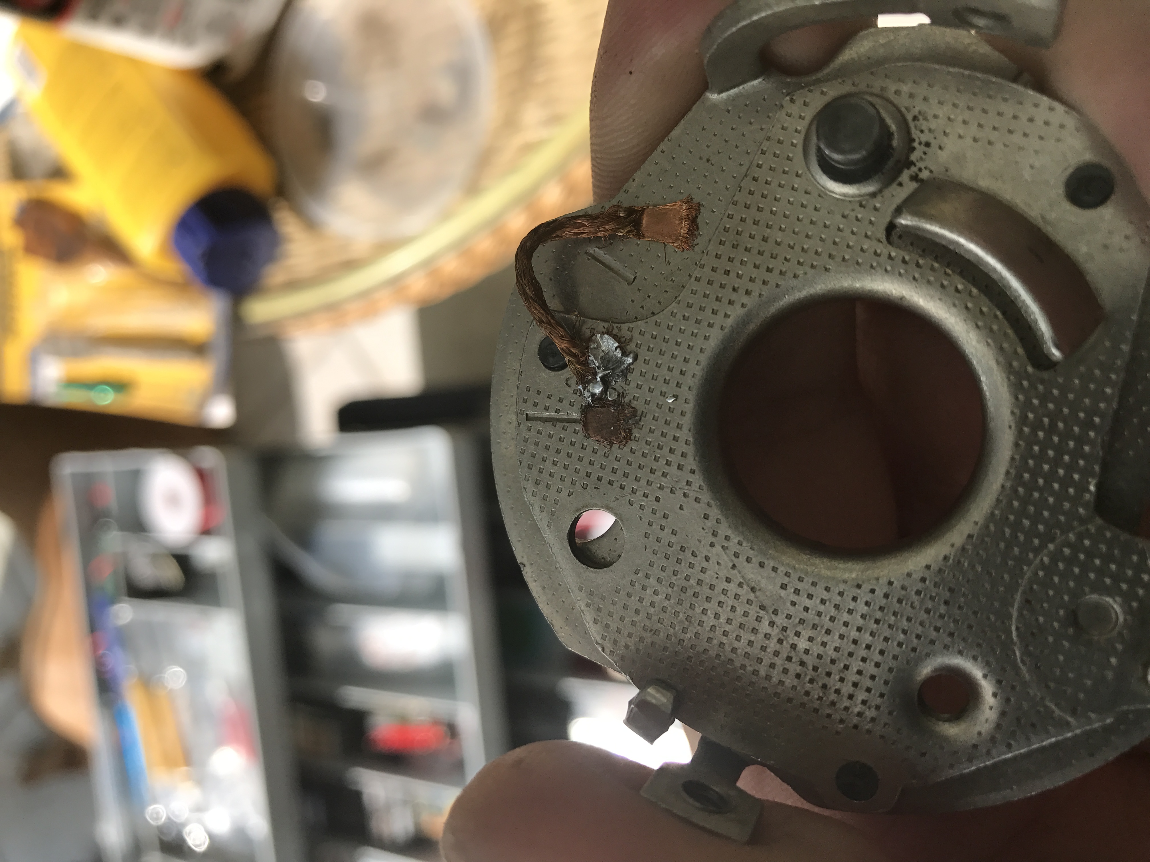

mgphoto   That is toast, soldering does not work. check wit...   Mar 10 2017, 07:01 PM

mgphoto   Did you try spraying starting fluid around all the...   Mar 10 2017, 07:08 PM
Brasil914   I have sprayed starting fluid and nothing. The sol...   Mar 10 2017, 07:35 PM
mgphoto   I have sprayed starting fluid and nothing. The so...   Mar 10 2017, 09:31 PM
Brasil914   I have sprayed starting fluid and nothing. The s...   Mar 11 2017, 06:04 PM
