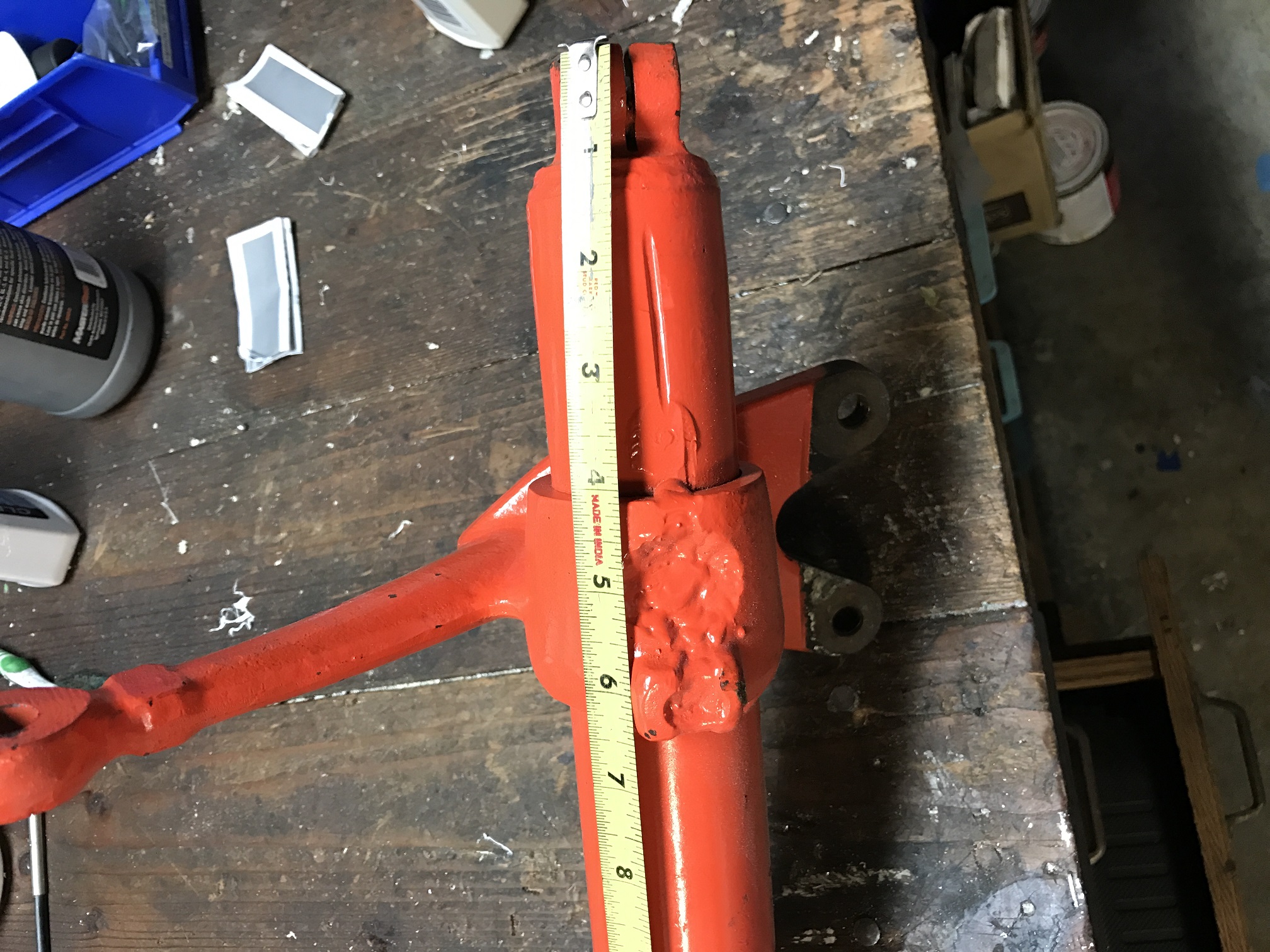

Can you still fit the wedge style of balljoint in these?
Like these: http://www.elephantracing.com/suspension/b...14balljoint.htm If so I am interested if you can ship to 80501 |

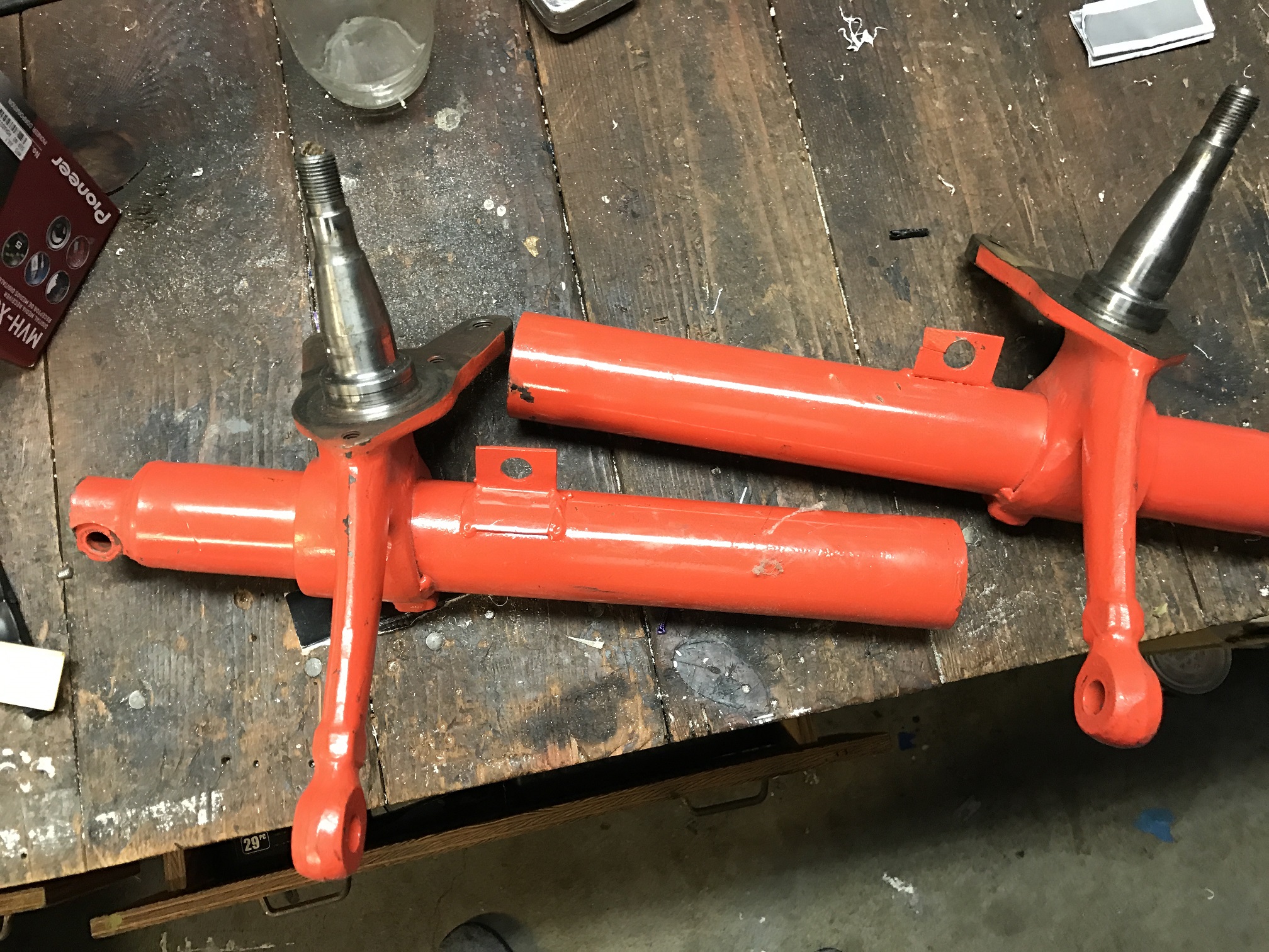

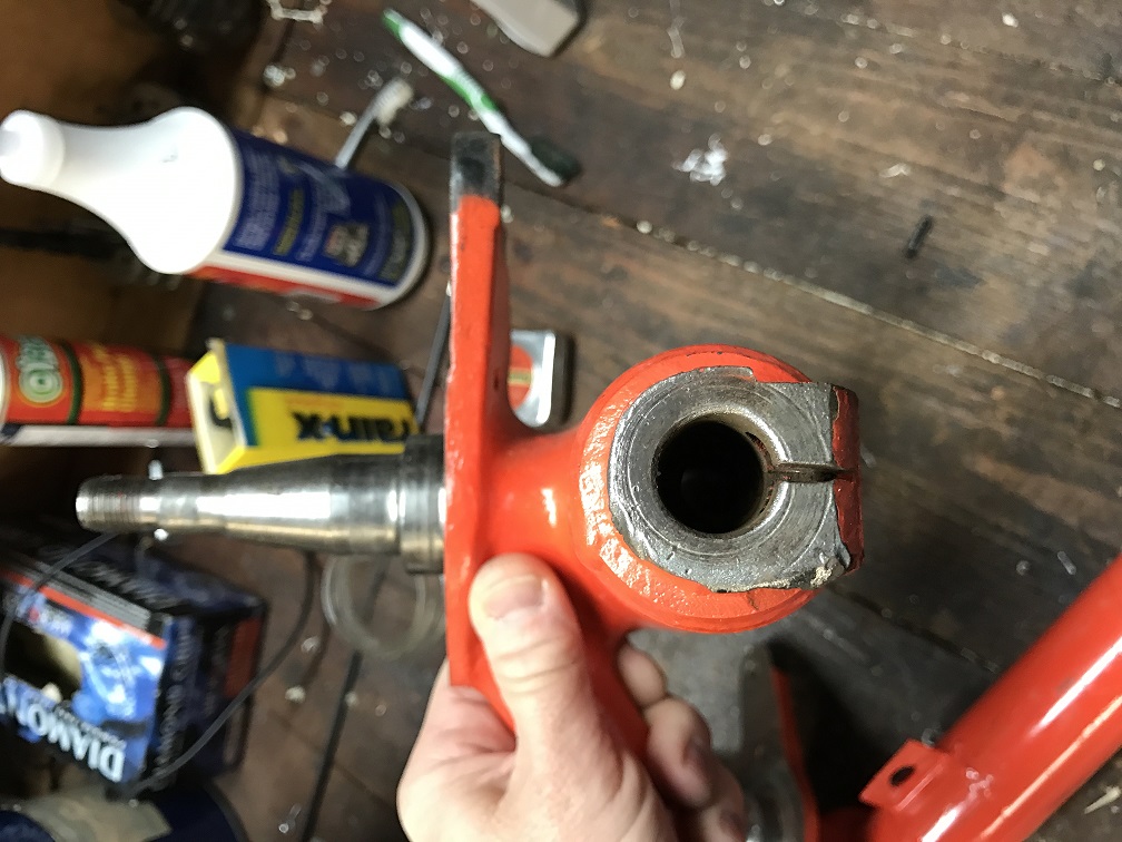

Not as they are made, Maybe they could be modified. First you should know that these will only work with early rotors and calipers. IF they can be converted to use on a later car you also need to change the flex lines and maybe the hard line from the caliper to flex line. I wonder if anyone has converted an early strut to use the wedge pin type ball joint and . The pinch joint early strut like these a have a 10mm hole through the bottom of the strut. The taper pin in 12mm on one end and 8mm on the threaded end. One side would need to be bushed from 12 mm to 8mm. The other side drilled out to 12mm. The slot for the pinch bolt needs to be welded. Porsche abandoned this design after only a couple years of use as it was a flawed design that could wollow out the ball joint hole. (per Cap't Crusty and he knew everything). So maybe you could but you need to decide if it is worth it as opposed to drop spindleing the late strut. If anyone has done this successfully please chime in. I just play with parts. I might put together the parts to see if the hole in the pinch bolt strut lines up with the notch in the wedge pin ball joint. Not trying to rain on the parade but providing info regarding the fitment and issues. Bruce |

Thanks for the additional info & commen... Mar 18 2017, 08:22 AM
