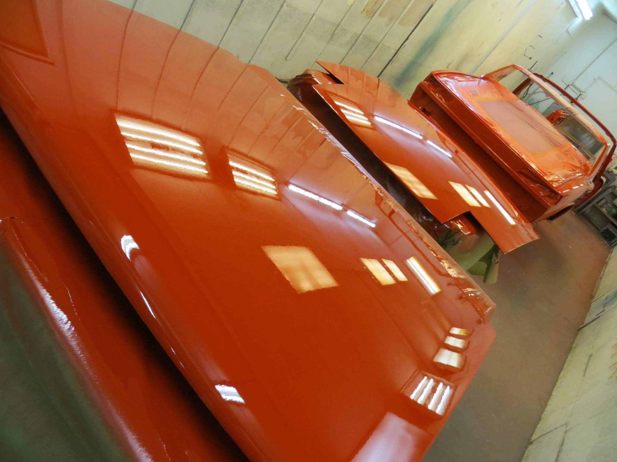

Matty900   Haven't posted progress on here for a little b...   Mar 14 2017, 11:19 PM
Matty900   Next was laying color down in the trunks   Mar 14 2017, 11:25 PM
Matty900   Finally Color   Mar 15 2017, 12:04 AM
Matty900   More photos   Mar 15 2017, 12:07 AM
Matty900   Engine bay is all good to go.   Mar 15 2017, 12:10 AM
Matty900   and lots and lots of cutting and buffing (over 25 ...   Mar 15 2017, 12:15 AM
