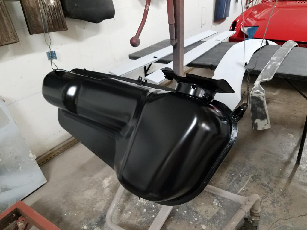

cary   What was the black stuff they sprayed in the trunk...   Mar 15 2017, 10:05 PM
Matty900   What was the black stuff they sprayed in the trun...   Mar 16 2017, 12:56 AM
cary   What was the black stuff they sprayed in the tru...   Mar 16 2017, 08:04 AM
Matty900   Tank looks like new. Now I just need to coordinate...   Mar 16 2017, 12:59 AM
