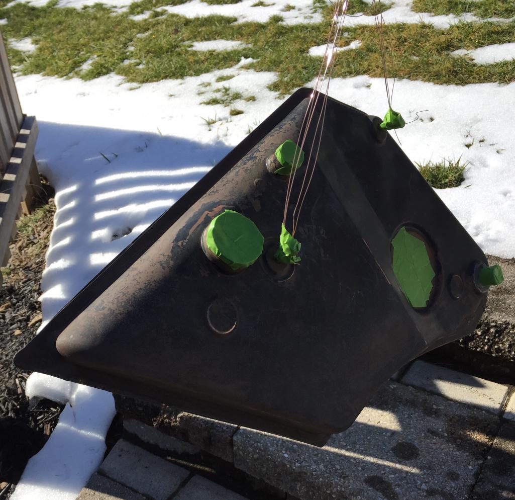

So it's sort of warming up here. Did a little but necessary project today.
Late start, wasn't in the mood to weld. Took care of the oil tank today.
Cleaned up, prepped, primered & painted. Prolly help Dave this week further
his. Hershey closing in. (IMG:style_emoticons/default/beer3.gif)
