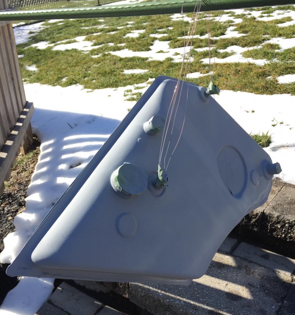

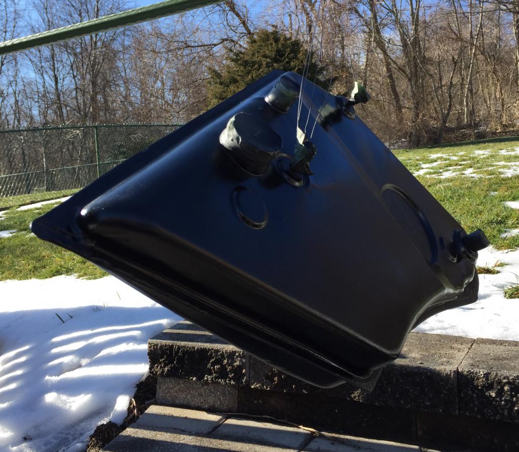

Dion   Some garage time this afternoon. Started prepping ...   Jan 26 2017, 04:23 PM
