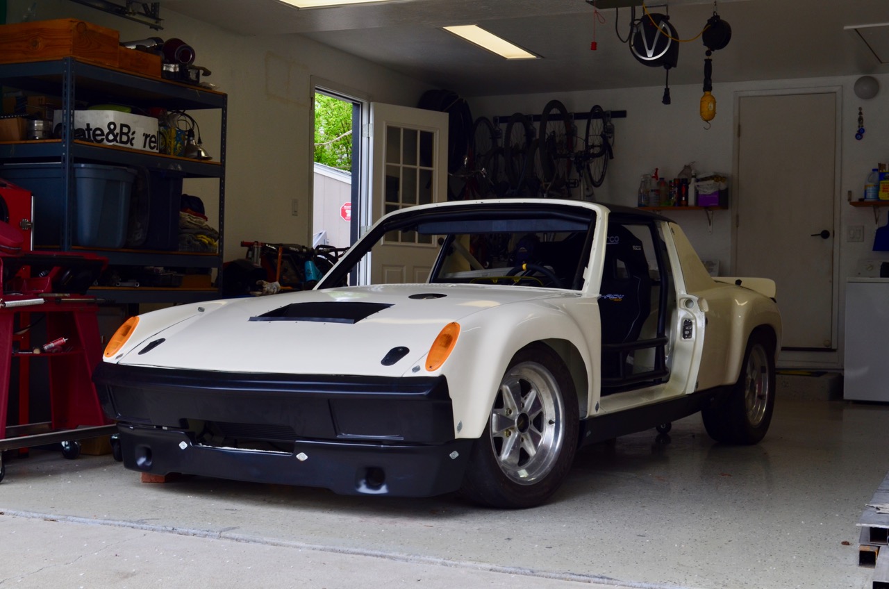

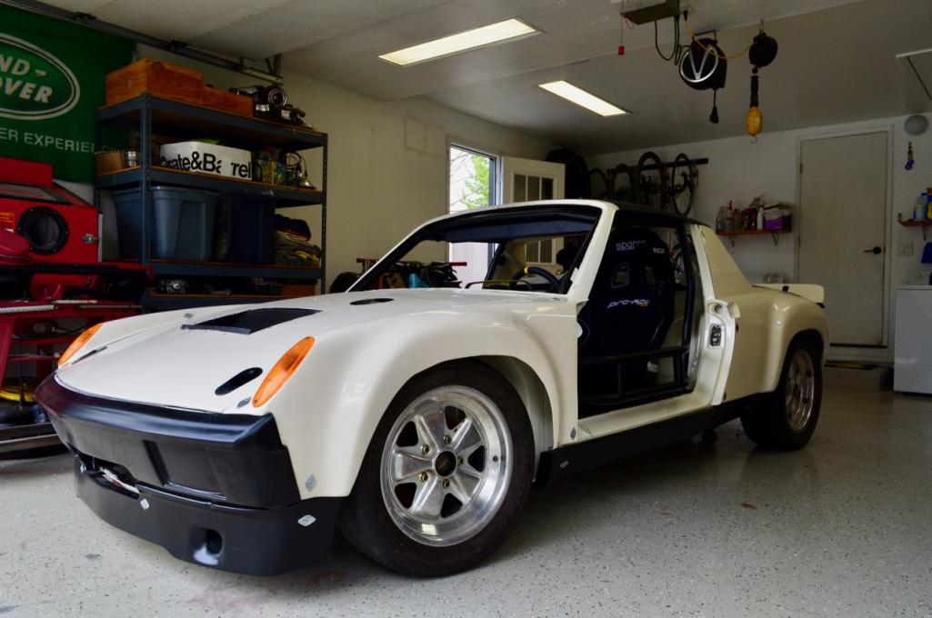

BIG NEWS: The car is on the ground.
Im trying to think of what to update you guys on as far as the last few months. Lets see..

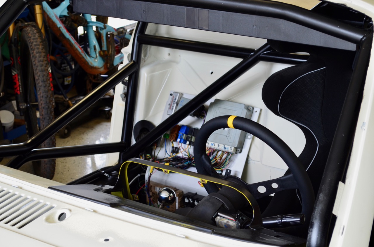

• Wrapped and installed the wiring harness
• Started work on the tail lights, Im gluing 3" LED trailer light cores into 914 buckets
• Bolted up the suspensions bits, plug-n-play for the most part.
• Ran brake, clutch and fuel lines. Easy, just time consuming.
Yeah, other than that, just invited a group of friends over and we got to work on lowering the chassis off the rotisserie today. Then we lifted the rear and slid the drivetrain underneath and put all into position. Now I have a big shit-eating grin every time I turn on the garage lights! Almost 2 years, countless weekends, yada yada yada, but I'll be damned, I've got a 914 roller in my garage.

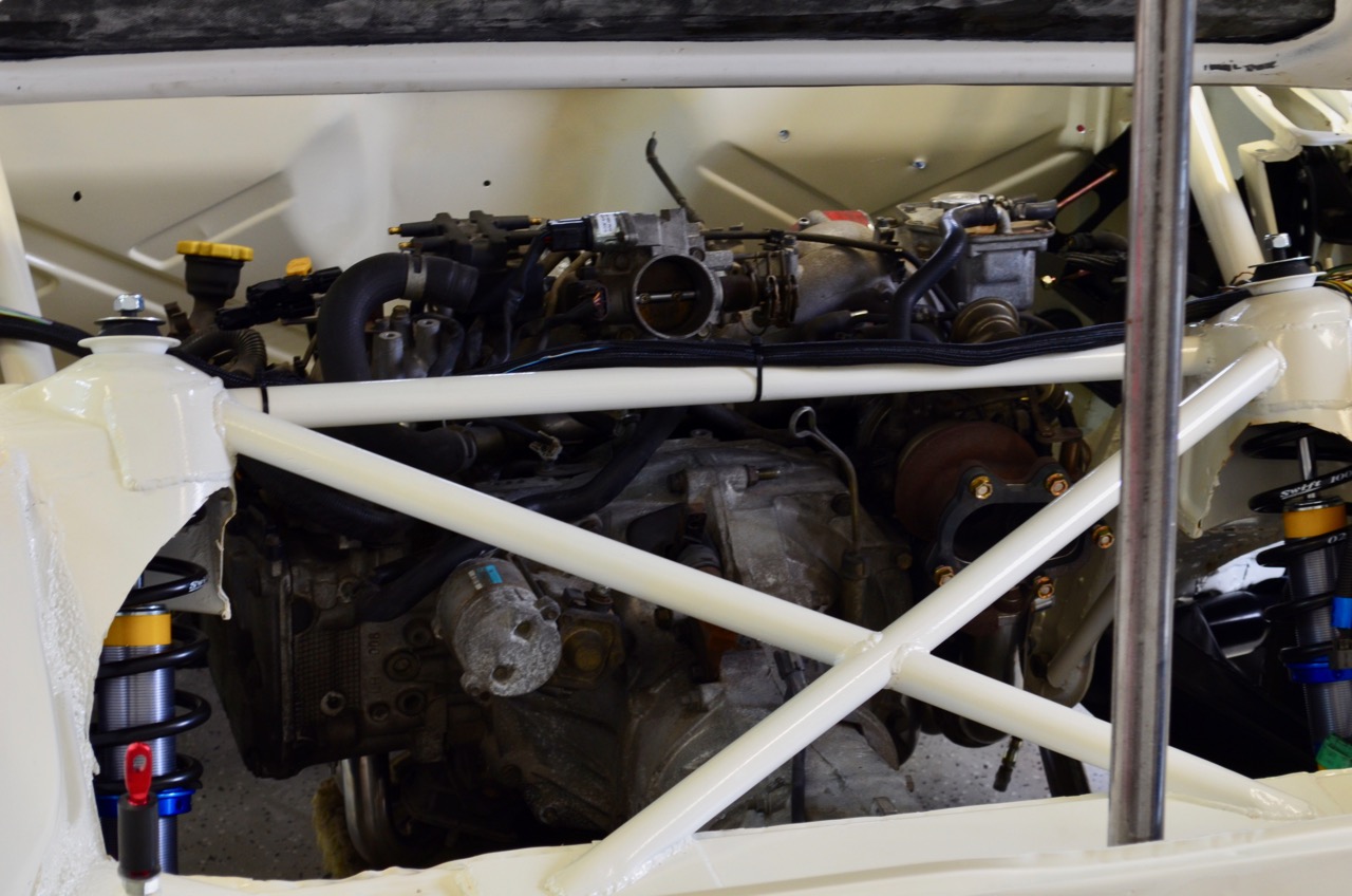

MichiganMat   Bought the motor and trans this past week. EJ205T...   Jan 31 2016, 12:33 PM
MichiganMat   Today I worked on dropping the drivers floor pan d...   Jan 31 2016, 10:32 PM

MichiganMat   Big update: Wiring. About a month ago I was able...   Dec 23 2016, 10:59 PM
76-914   If you need an excuse to drink, this is it. Good j...   Dec 24 2016, 10:23 AM
MichiganMat   Mounted all the wiring to an aluminum panel which ...   Dec 24 2016, 04:30 PM

MichiganMat   Had a busy weekend with the 914. Built the engine+...   Mar 27 2017, 03:57 PM
tygaboy   That's looking great! Curious about the cu...   Mar 27 2017, 04:41 PM
MichiganMat   That's looking great! Curious about the c...   Mar 27 2017, 07:29 PM
MichiganMat   Mocked up the location of the IC, yanked the drive...   Mar 28 2017, 01:15 AM
