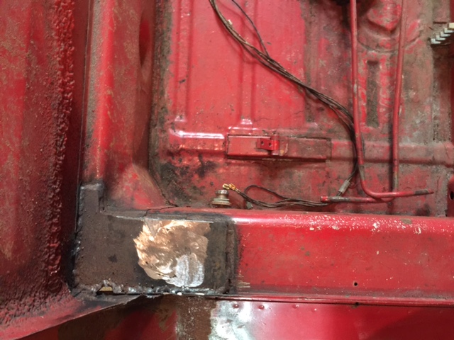

I ground down the stumps from the roll cage. Doesn't look like much but it took a while. Especially in the engine compartment. Unfortunately, the welded in pads are going to stay. It's just too much work to remove them. Maybe one day.

mepstein   I ground down the stumps from the roll cage. Doesn...   Mar 20 2017, 03:13 PM
76-914   Uh, I hate to ask but is that a rust sensor screwe...   Mar 20 2017, 03:18 PM
Andyrew   Looks like a seat belt bolt   Mar 20 2017, 03:41 PM
mepstein   Just the seat belt bolt and a wire. :D   Mar 20 2017, 03:41 PM
