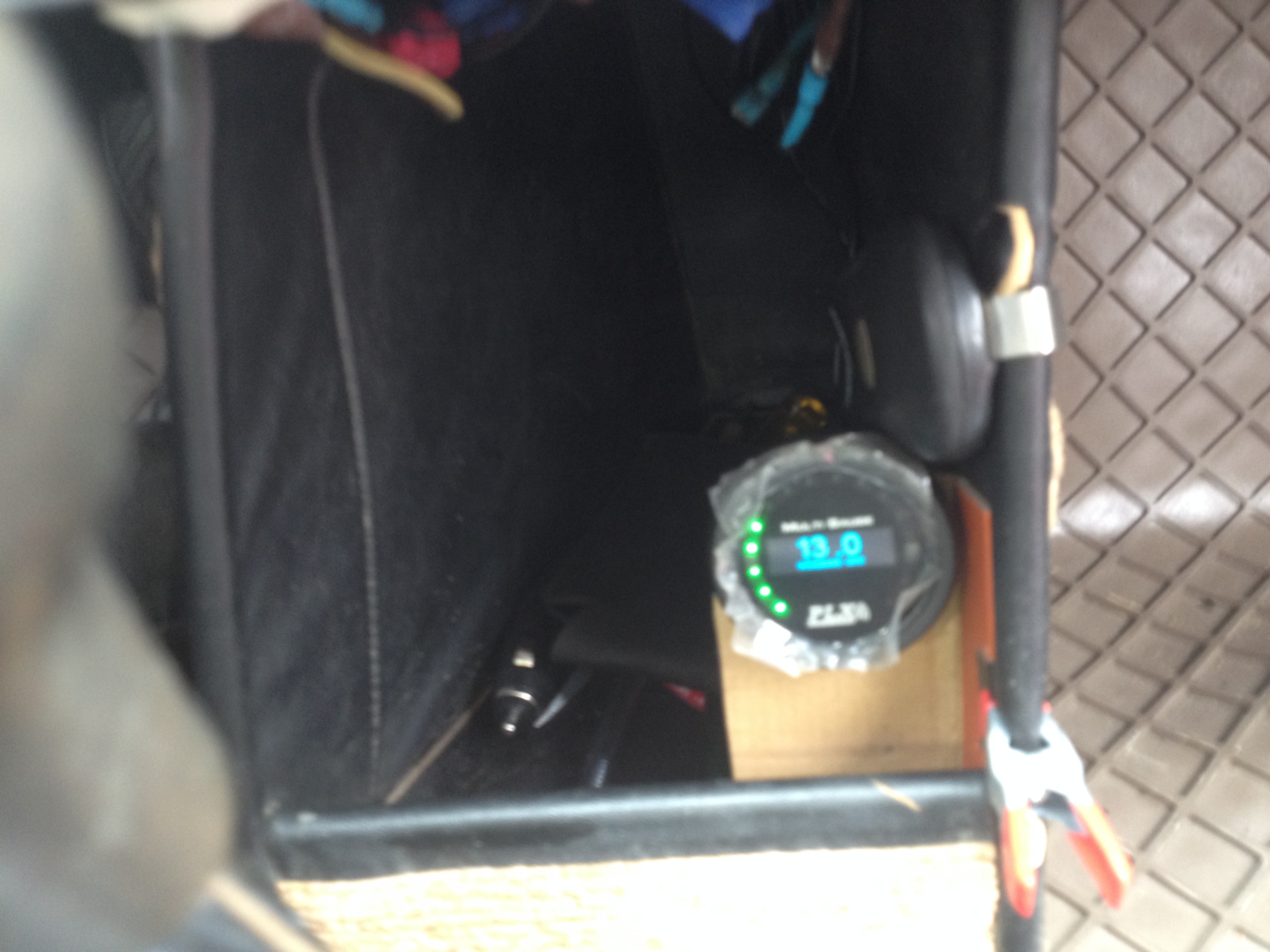

PLX is now installed. The guage is temp'd in with a shoe box and a clip.
Reading was 13.8 to 14.5 last night. I closed my CO screw one full turn. Cruising and hills reading is now 12.7 to 13.5.
Heading to NC at lunch. 5 hour drive. I will enjoy monitoring it.
