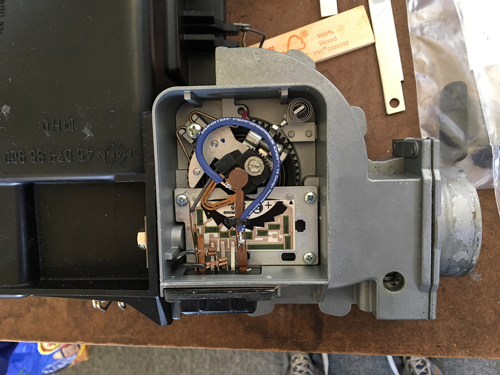

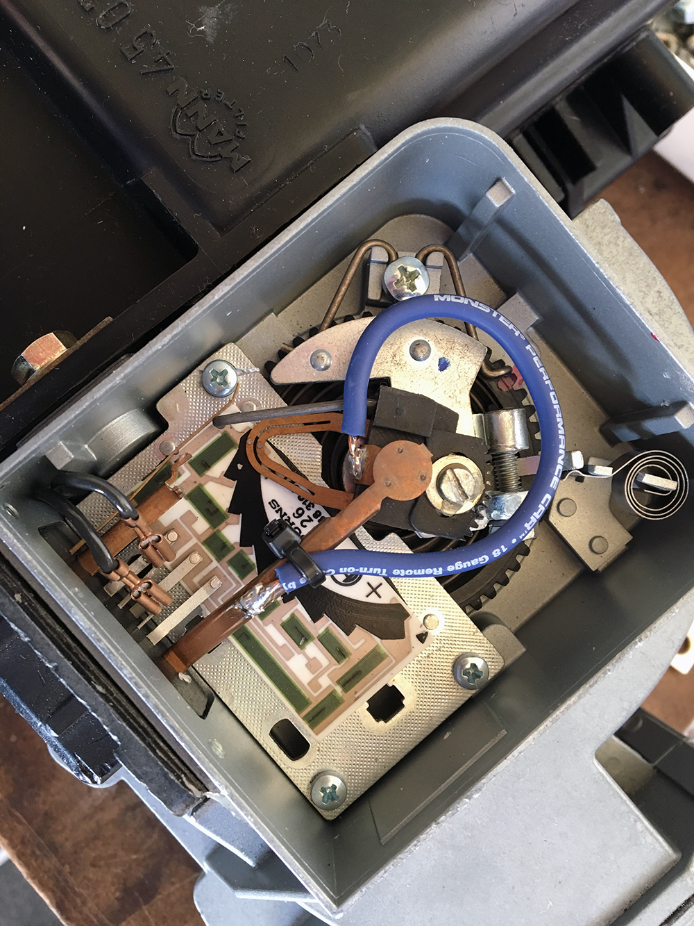

I have been playing around a bit with my AFM. I have a couple of them so I figured one would be a good test mule. I read about a mod the VW Bus guys were doing. The later Bosch AFMs had a jumper wire installed to help the conductivity. This is an easy upgrade to do by soldering a jumper wire from the wiper arm to the large connector bar (See blue wire). I also cleaned all the contacts while I had it apart. I did a before and after OHM test and the numbers seemed to smooth out a bit after the mod and tune up. There are You Tube videos on all of this.
Now to try to get some time to get out and test the AFR results. (IMG:style_emoticons/default/driving.gif)
