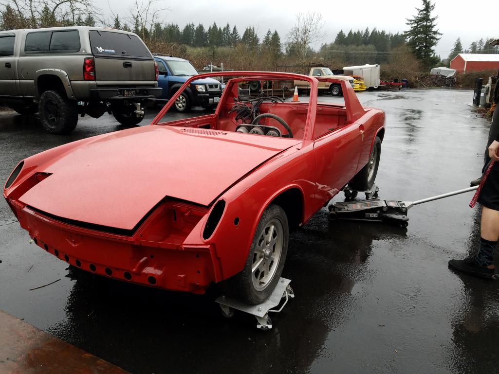

Cary Kutter cam out to the body shop last Saturday with his enclosed trailer and pick up the car. He brought it back to his shop, Middle Motors where we will continue the project. He has been gracious enough to let me work on it on his lift and give me guidance that I will definitely need a lot if. Thank you Cary.

Matty900   Some updates Cary Kutter cam out to the body shop ...   Mar 24 2017, 12:59 AM
