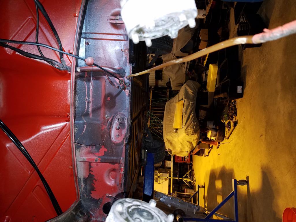

Pulled the factory fuel lines to replace them with new stainless steel lines.

Matty900   Pulled the factory fuel lines to replace them with...   Mar 24 2017, 01:23 AM
