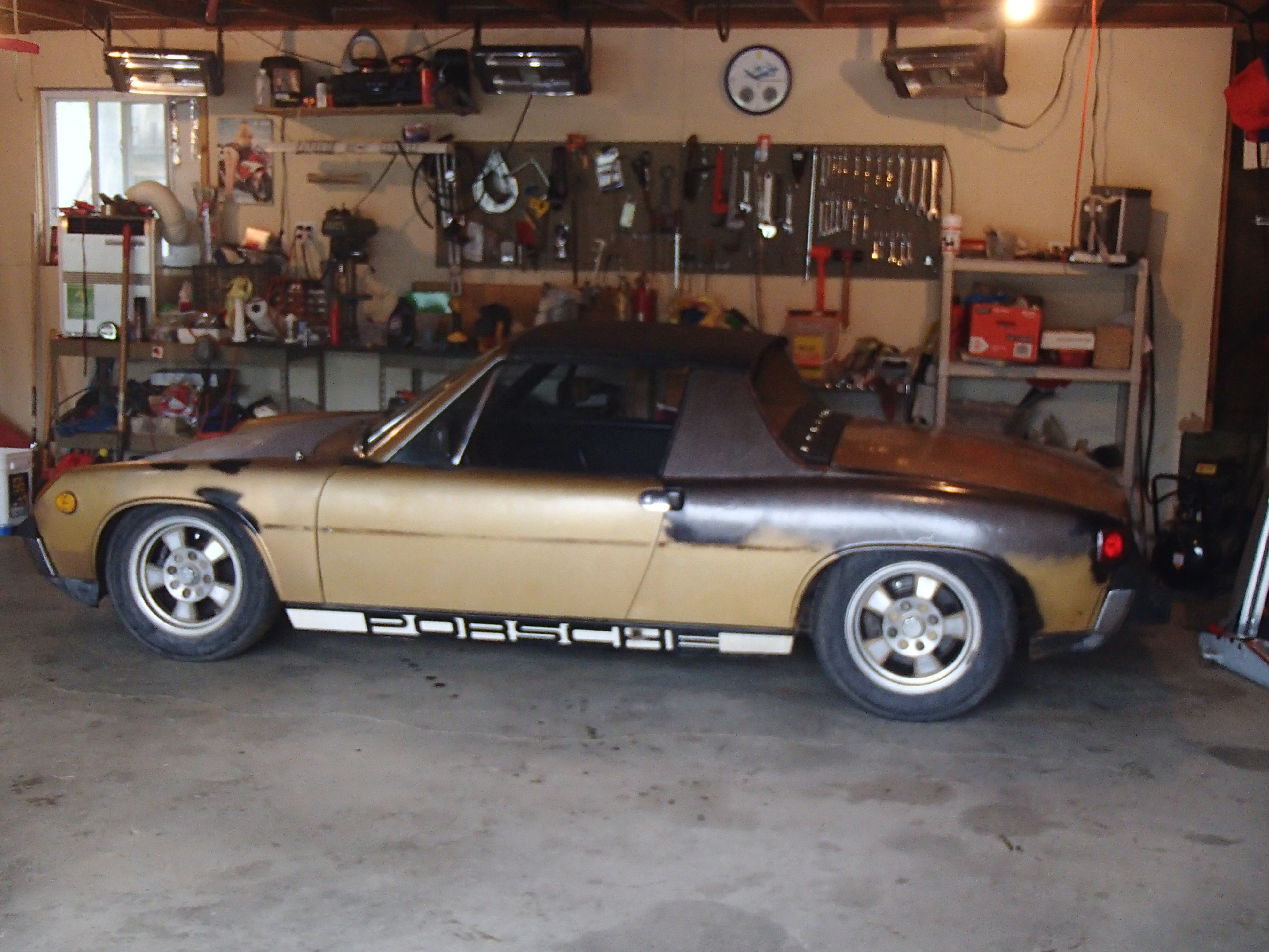

Good thread. I am embarking on my own AC install project on my 914 project. AC is about the only way I'll be able to get my wife and daughters to ride in the car in the summer. I have a new left over kit for a 70 Torino that I traded before off getting around to installing it with a sanden 508 compressor and under dash unit. My 74 914 has a 2.0 bus engine in it with a dual carb set up. My idea so far is mounting the compressor on top of the engine on the left drivers side and driving it with a double pulley mounted on the alternator and fabricating the bracket using the mounting base and adjustment mechanism from the ford 351 bracket I already have.
