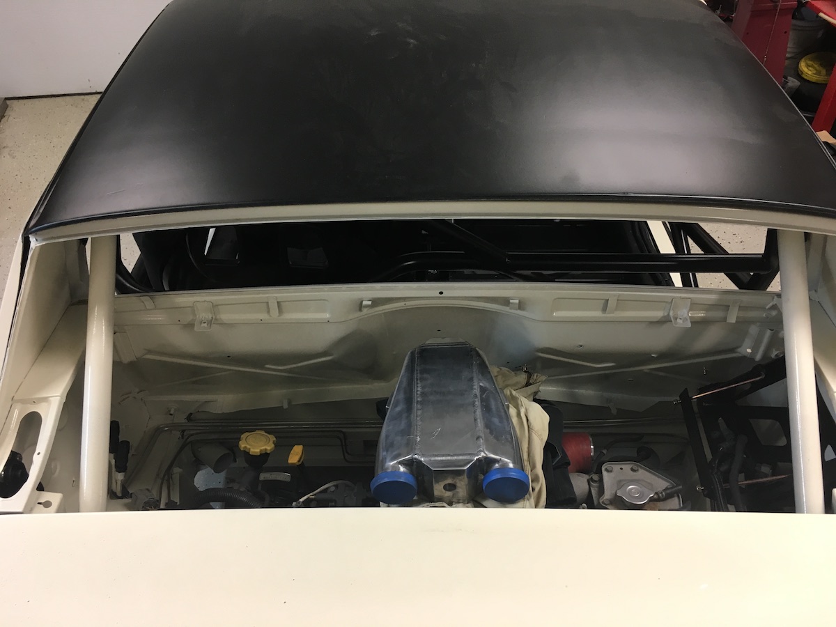

MichiganMat   Had a busy weekend with the 914. Built the engine+...   Mar 27 2017, 03:57 PM
tygaboy   That's looking great! Curious about the cu...   Mar 27 2017, 04:41 PM
MichiganMat   That's looking great! Curious about the c...   Mar 27 2017, 07:29 PM
