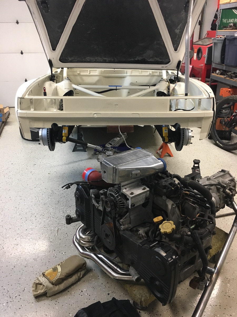

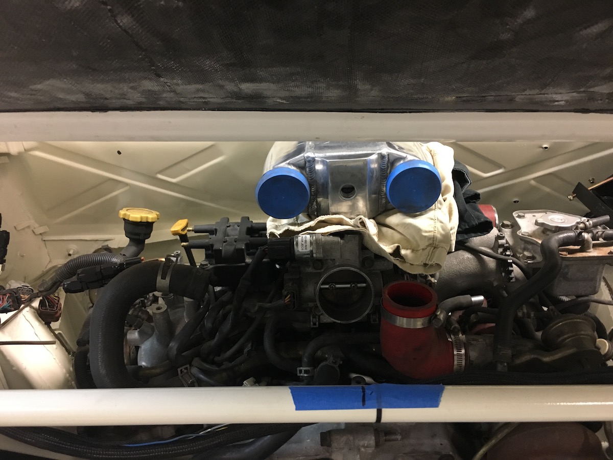

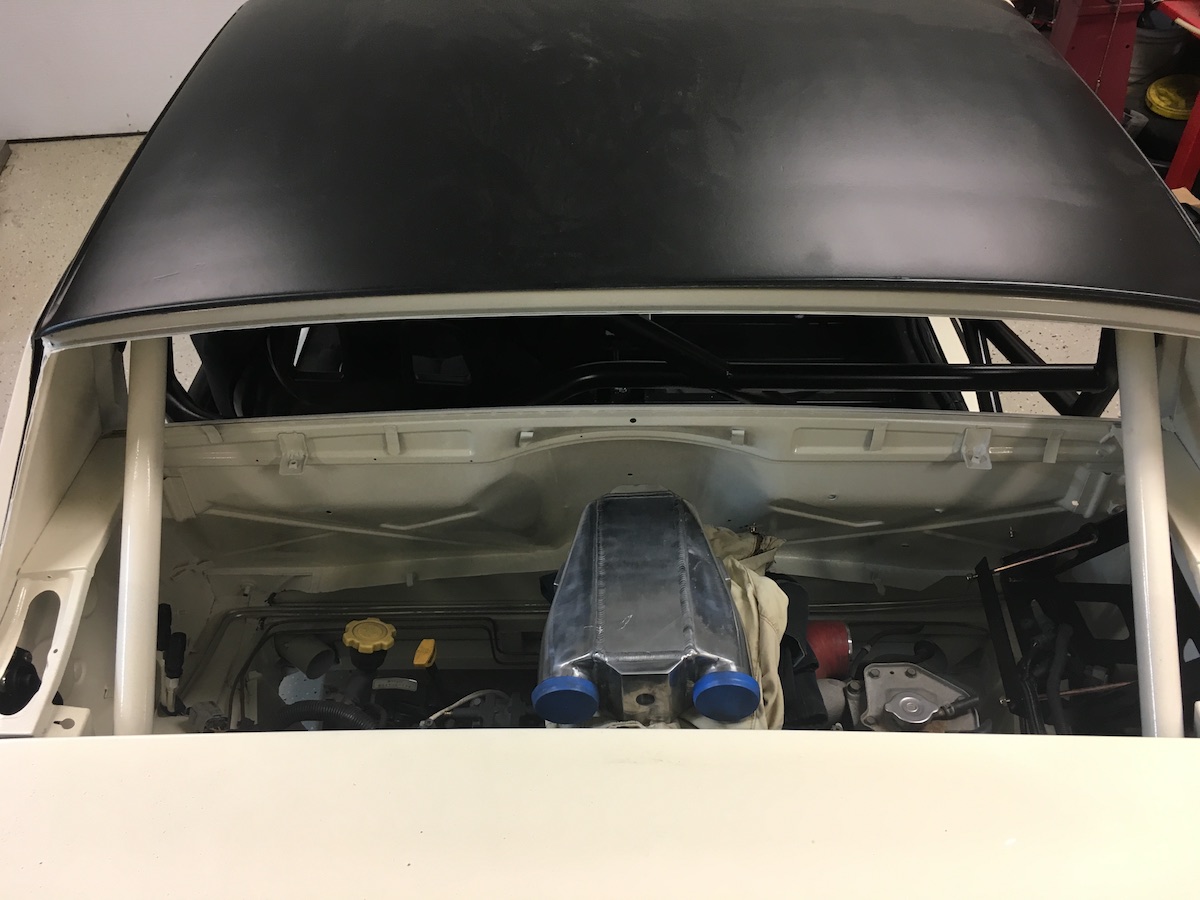

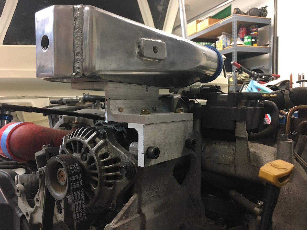

Mocked up the location of the IC, yanked the driveline, cut some material, and mounted it up.
Its just a little platform at this point, but I'll weld some threaded rod to the bottom of the IC, drill some holes in the platform, isolate it with some rubber, and bolt it down. The IC is going to be full of water so I figured Id build a tough strong mount for it.
