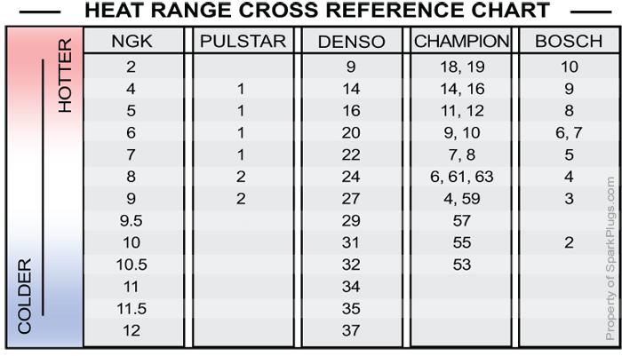

Olympic 914
post Mar 28 2017, 07:55 AM
Posts: 1,793
Joined: 7-July 11
From: Pittsburgh PA
Member No.: 13,287
Spark plugs are an easy change, you could try NGK 6 in there, its one step colder.

Mark Henry   I'd say that plug is a tad hot, what number is...   Mar 27 2017, 05:17 PM
malcolm2   I'd say that plug is a tad hot, what number i...   Mar 27 2017, 07:11 PM
Olympic 1.7   Spark plugs are an easy change, you could try NGK ...   Mar 28 2017, 07:55 AM
