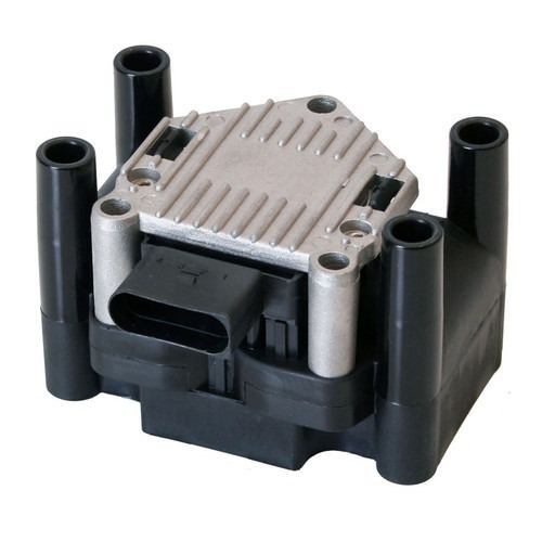

VW bug Beetle golf oem 2.0 ignition coil pack assembly 032905106b $20

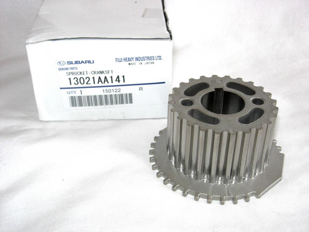

Subaru WRX OEM Crankshaft Timing Sprocket pn-13021AA141 $30

modern 5spd transaxle - useable 1st gear for taking off from dead stop & in traffic

spencer suggested this coil. coil 032906106b. it combines coil and exciter in one unit (IMG:style_emoticons/default/smile.gif)
https://www.youtube.com/watch?v=wcek255pXHI
http://www.tasteslikepetrol.net/2017/02/sp...coil-mount-cad/
