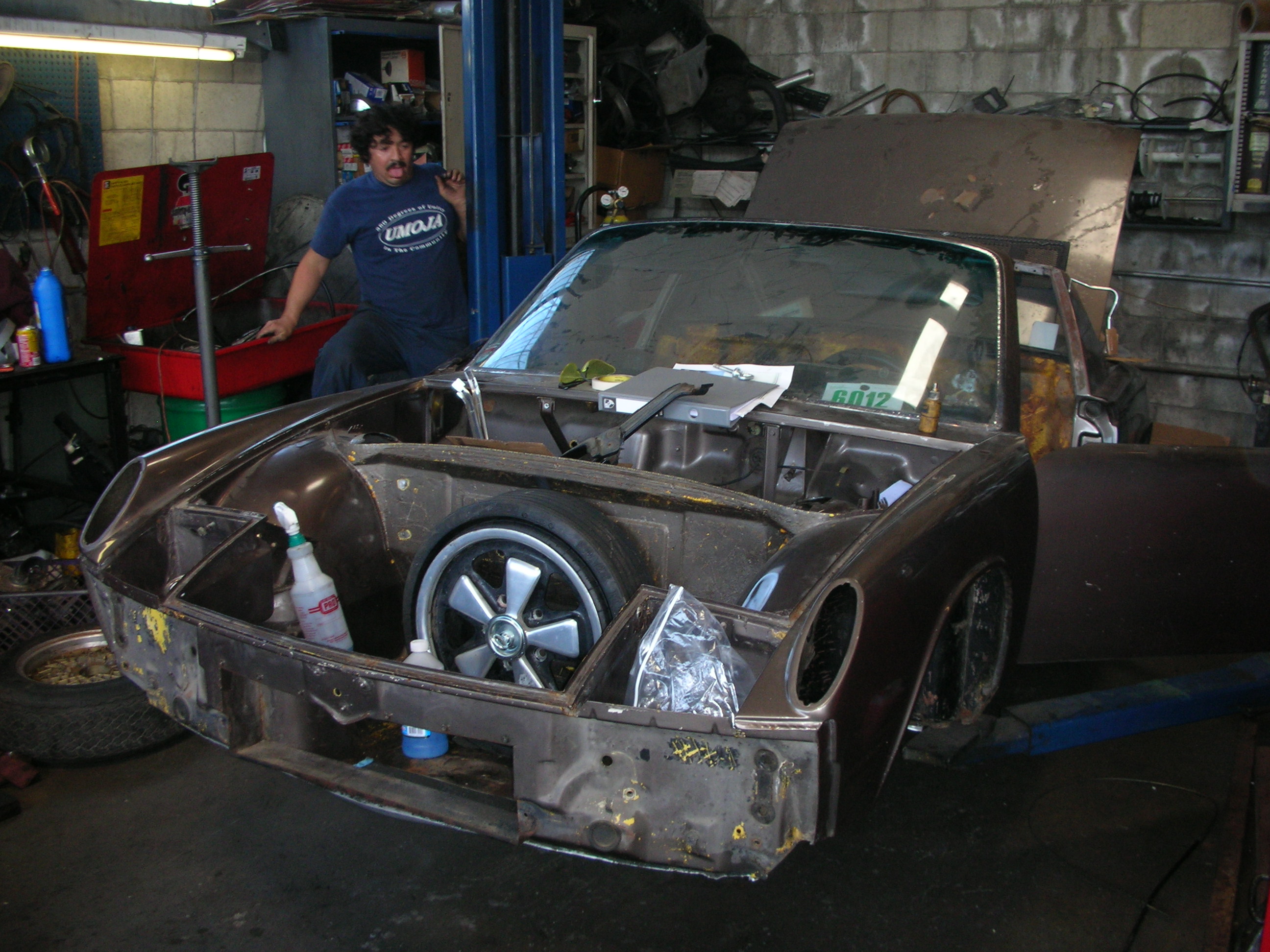

The body shop next door with the cooler removed. Sergio next door. Cool guy that looked like Mario the plumber.
