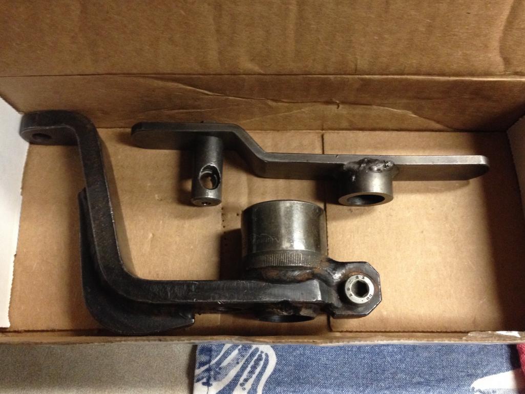

Another small step for me, one giant leap for my transmission!
P 259 by way of Meaney Racing, possibly used on the Daytona cars # 18 and #19.
A small ring, a few shims and the patience of a saint.
Mike
