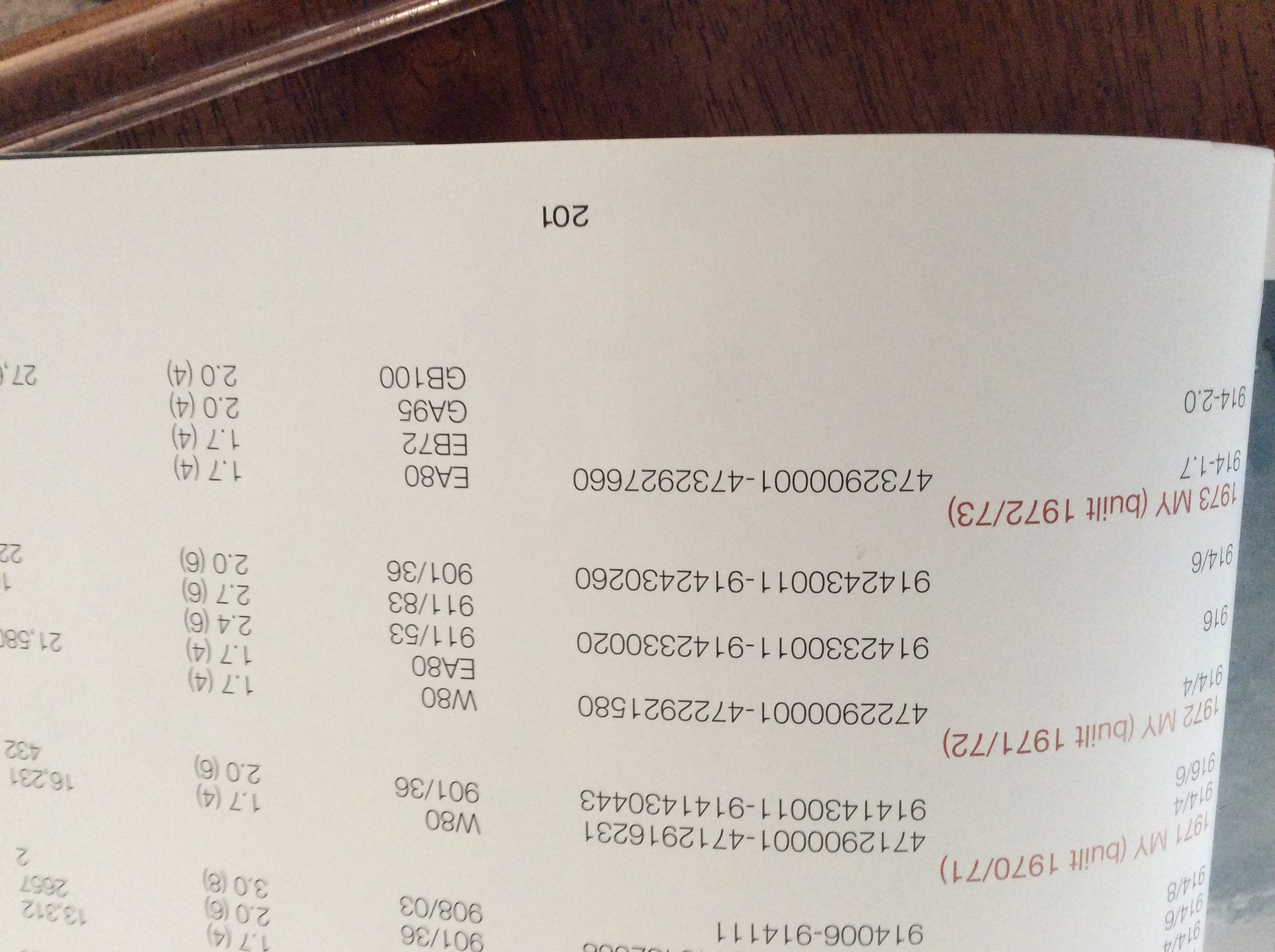

Hi Everyone,
I am being taxed as if I have a 2.0 when I really have a 1.7. So, I need to "prove it" to our state govt. Is there anywhere on the car that lists the engine size? I checked the door jam info and it wasn't listed there, the engine compartment and found nothing. Any other ideas?
Thank you for any help,
Ross

A little ore detail...

ConeDodger   COA. If it's originally a 1.7, the COA will sa...   Apr 17 2017, 11:58 AM
Tom_T   COA. If it's originally a 1.7, the COA will s...   Apr 17 2017, 12:07 PM
Ross   Thanks guys. You guys are awesome as usual. beli...   Apr 17 2017, 12:17 PM

Tom_T   You can also look for the case no. - see Jeff...   Apr 17 2017, 12:04 PM
Vacca Rabite   Your state taxes by engine displacement on classic...   Apr 17 2017, 12:06 PM

Ross   hmmm, that's interesting. It is a 72. I am g...   Apr 17 2017, 01:03 PM
mepstein   hmmm, that's interesting. It is a 72. I am ...   Apr 17 2017, 01:08 PM
Ross   well the DMV was nice enough to tell me that the n...   Apr 17 2017, 01:12 PM
ConeDodger   well the DMV was nice enough to tell me that the ...   Apr 17 2017, 01:23 PM
Cairo94507   They are full of BS. That car only came with a 1....   Apr 17 2017, 01:26 PM
arne   Yes, the owners manual may be all you need. Your c...   Apr 17 2017, 01:30 PM

Ross   Do all 1.7s (mine is a 1972) have the chrome numbe...   Apr 18 2017, 06:54 AM
mgphoto   Do all 1.7s (mine is a 1972) have the chrome numb...   Apr 18 2017, 05:03 PM

rhodyguy   Maybe I've missed it. Have you asked what crit...   Apr 18 2017, 07:36 AM
Ross   They have simply said to supply proof of my disagr...   Apr 18 2017, 08:04 AM
Vacca Rabite   Could the "VW 1700" be referencing th...   Apr 18 2017, 08:30 AM
mepstein   http://www.p914.com/p914_engine.htm   Apr 18 2017, 08:24 AM
Ross   thanks Zack. Looks like I will be sending them a ...   Apr 18 2017, 12:32 PM
GeorgeRud   1972 did only have 2 models available, the 2.0 -6 ...   Apr 18 2017, 03:31 PM

ConeDodger   From Brian Longs book   Apr 18 2017, 06:02 PM
ConeDodger   A little ore detail...   Apr 18 2017, 06:03 PM
