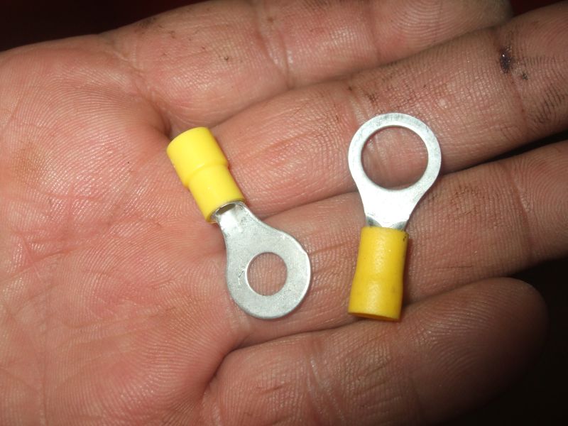

Ring connectors from your local FLAPS seem to come in two sizes, way too big and too small. (IMG:style_emoticons/default/dry.gif)
Get the too small ones made for 10 gauge wire, with the yellow ends.
