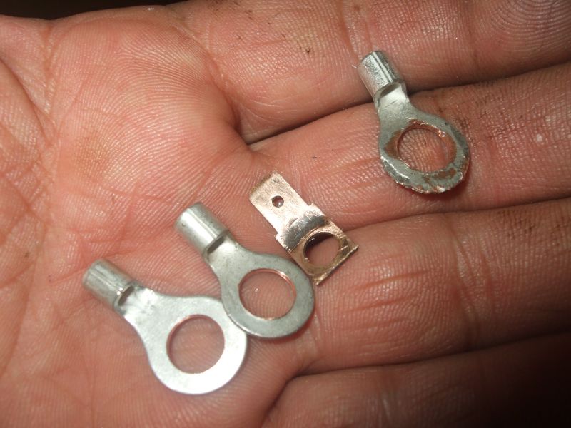

So these are the connectors needed, but in a brain fart moment I forgot the one female quick connector that is also needed.
The tab connector I had, I think it was on an old VW wiper assembly. Likely you can get them from McMaster-Carr but I think they only come in boxes of 100.
You can make one ghetto from a connector or fab one yourself by cut/drilling it out from some copper pipe although pipe is a bit too thick.
The hacked up ring connector shows how bad it gets trying to drill them with regular drill bits. Rack your fingers a few times when the connector catches and spins and you'll be out picking up a step drill bit PDQ.
