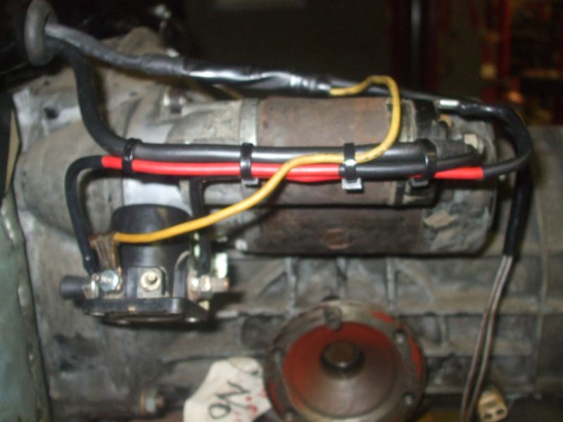

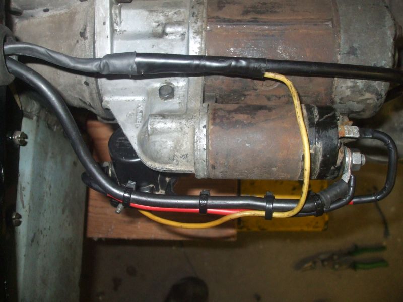

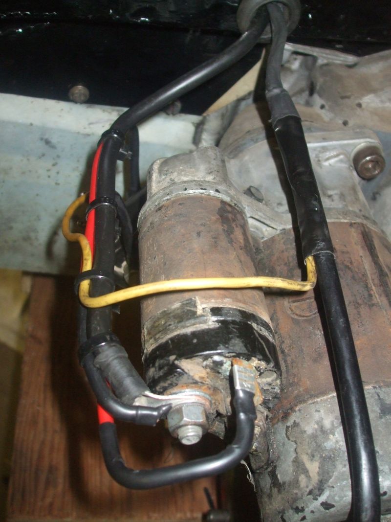

Just to calm some peeps fears I did some housekeeping on my install and made it even better. I shaped the main battery cable so it runs right beside my wires, then I zip-tied the whole bundle together.
So that's a 3 gauge and two 10 gauge wires tied together, the thing is almost like a solid pipe. If the nut holding the solenoid on was to come loose the solenoid still isn't going anywhere.
Short of something catastrophic, like an axle failure, I'd say it's now bulletproof.
