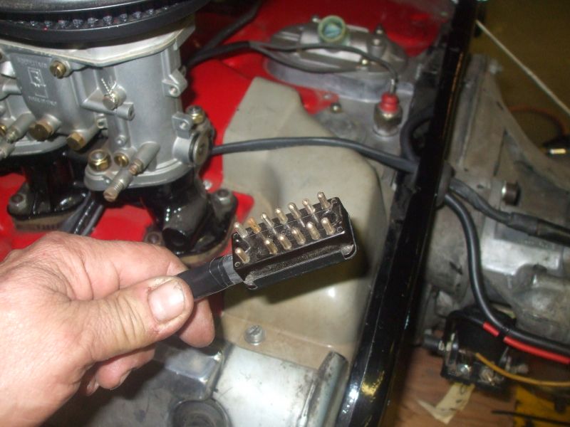

I know I've said I dont like to cut factory wires, but this is all part of my custom /6 conversion harness.
This is the custom end of the engine harness I made from an salvaged main harness and pins from an old relay board. My /6 engine is total plug and play with about 6 connectors and the relay board has been deleted.
The harness stays on the engine for R&R.
