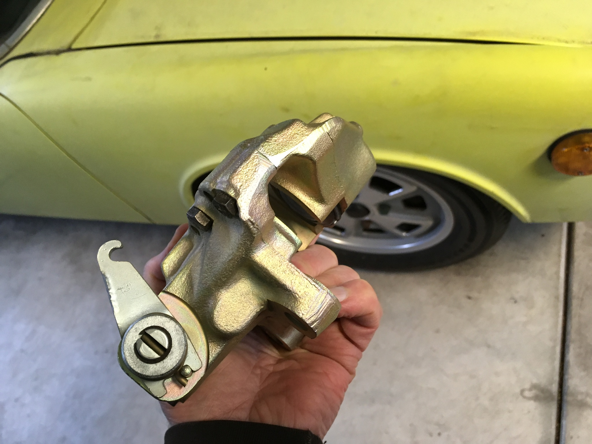

Some gratuitous 914 brake p0rn.

arne   Some gratuitous 914 brake p0rn.   Apr 27 2017, 12:35 PM
