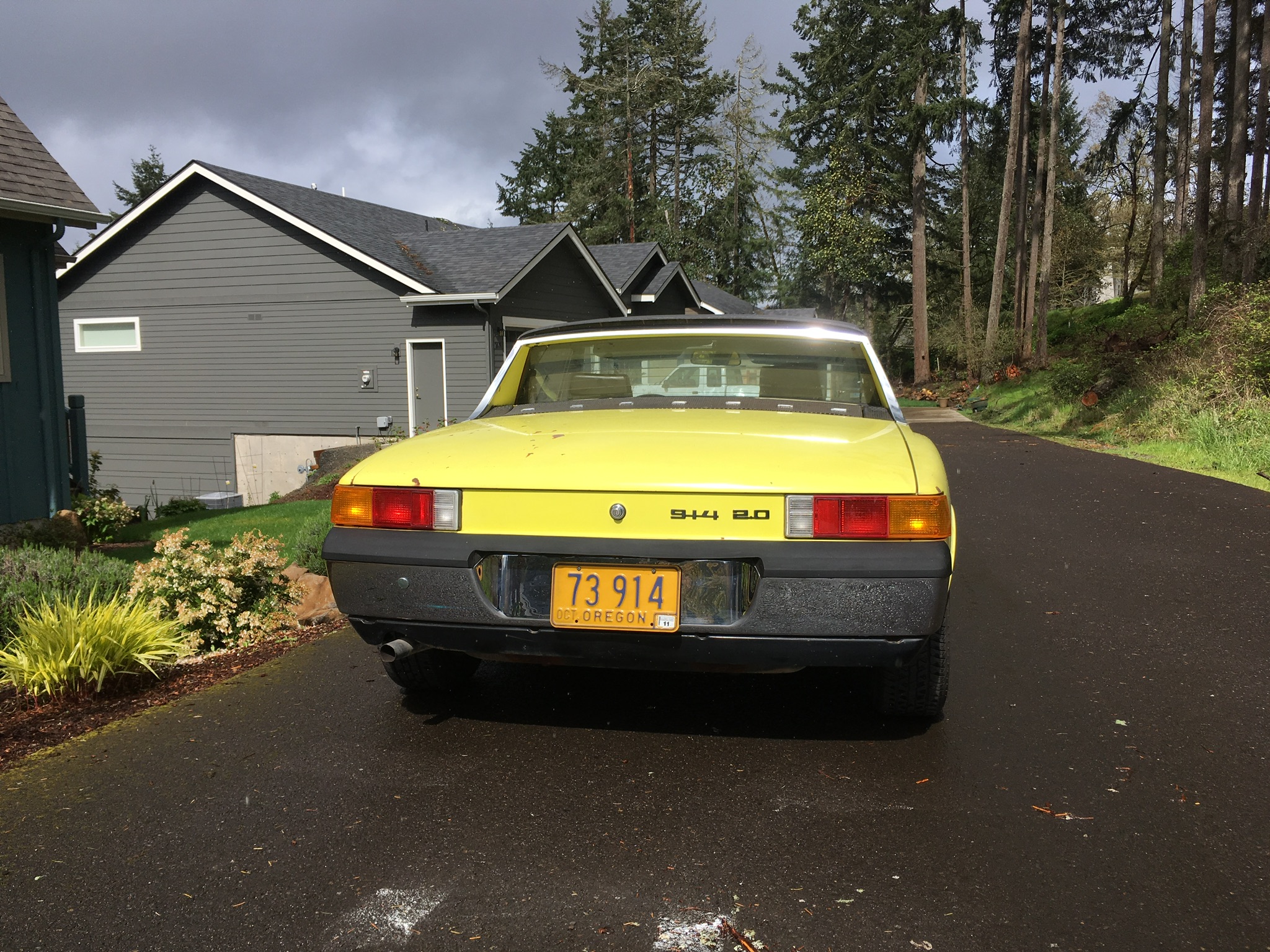

Well, as I posted at the end of my intro thread ( http://www.914world.com/bbs2/index.php?sho...=303932&hl= ), I bought my 914 over the weekend. We've all heard of barn and garage finds, this car was found in a large storage unit.
Details - '73 2.0, 4732924138, yellow. Appears to me to be Saturn or Chrome yellow, but I never looked at the paint plate to say for sure. Will confirm that and correct later. Confirmed, L13M, Saturn or Chrome Yellow. Odometer shows just over 72k miles, seller claims that is correct, but I haven't gone through the paper trail to verify. The car does look like that could be accurate. I am the fourth owner.
Rust seems limited to the battery tray, passenger floor and right sail panel (where water obviously got trapped behind the vinyl). The hell hole looks solid at this point. None of the rust appears to be holes yet. Definitely some work to do there.
The car was said to run when it was parked in the unit, other people not involved in the sale confirmed that it drove in under its own power. Been sitting for 6 years or so. After it got in, the seller began very rudimentary prep for restoring it, but life got in the way. So about all that was done was to pull all the lenses off.
I'm waiting for a flatbed to gather it up now, should have it in my garage later today. Here are a couple of pictures to show the beginning.
