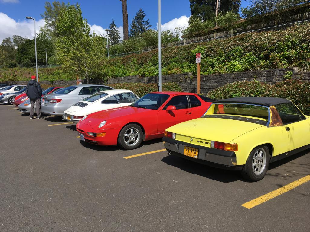

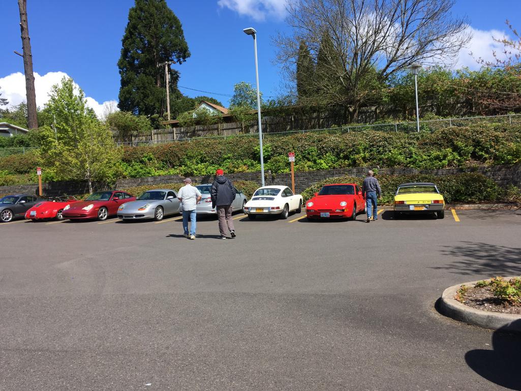

Drove it to the local PCA monthly coffee gathering today. (For any of you near Eugene, 1st Saturday of each month, 10:00 at Market of Choice at 29th & Willamette. Park way at the north end in back.)
Admitting that it still has some needs, especially in the suspension, I can see that these cars are a riot to drive, even with just a stock 2.0. This is getting fun.
