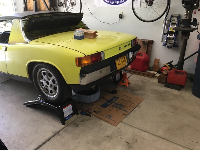

arne   Pretty sure I don't need to remind anyone here...   May 18 2017, 10:41 AM
euro911   I think you'd be better off dropping the drive...   May 18 2017, 11:30 AM
arne   Yeah, I'm sure you are right, Mark. I've b...   May 18 2017, 11:52 AM
mepstein   I've done it with the rear wheels on wheel ram...   May 18 2017, 12:16 PM
euro911   I whole-heartedly agree with Mark Epstein ... it...   May 18 2017, 12:41 PM
arne   Mr. Epstein's ramps must be taller than mine. ...   May 18 2017, 12:57 PM
mepstein   Mr. Epstein's ramps must be taller than mine....   May 18 2017, 01:46 PM
arne   OK, I'll give it a shot. I guess worse case is...   May 18 2017, 02:08 PM
mepstein   OK, I'll give it a shot. I guess worse case i...   May 18 2017, 03:14 PM
euro911   It's always nice to have some help doing this,...   May 18 2017, 03:00 PM
arne   I have access to a pair of ramps that will give me...   May 18 2017, 03:33 PM
arne   Now thinking about the "while I'm in ther...   May 18 2017, 08:23 PM
