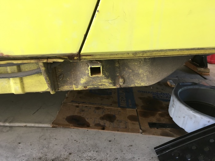

arne
post May 20 2017, 05:32 PM
Serial Rescuer of old vehicles...
Posts: 811
Joined: 31-January 17
From: Eugene, Oregon
Member No.: 20,799
Left long and jack point exposed today.
