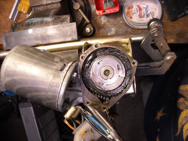

So in preparation for the dreaded airbox install I decided to inspect, test, clean and lube the wiper mechanism. The lube part went ok but getting the wipers to park was another story. The instructions in both the Haynes and Clymer manual will not work to get the wiper into a park position for a bench test.
I found I had rig a switch to mimic the column switch to get them into park.
http://www.914world.com/bbs2/index.php?sho...=304921&hl=

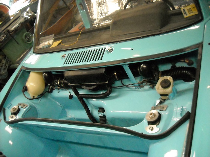

Then on to the air box install. The teener gods were with me that day as it only took about 1 ½ hours to get the airbox in. I admit I had to cheat a little and elongated the mounting holes. But it went in much better than I expected.

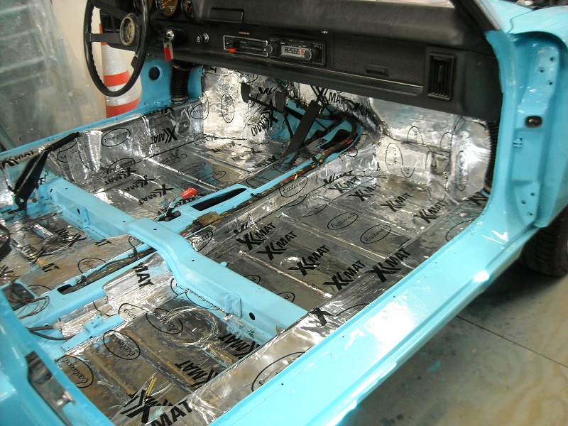

Moving to the interior I installed some Xmat sound deadner from Eastwood. Using paper I first made patterns and after getting a good fit transfer that to Xmat. It cuts easily with sharp scissors. Before putting it in place I waved it over my heater for a couple seconds to warm up the butyl rubber backing making it more flexible and stickier.

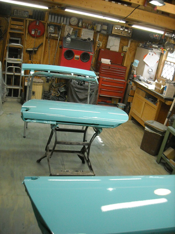

Then after waiting on a warm day I got the doors finally painted.
And had a friend help with the install. I put the tape on the edges to prevent nicks in the new paint while we were handling them.
its coming along.

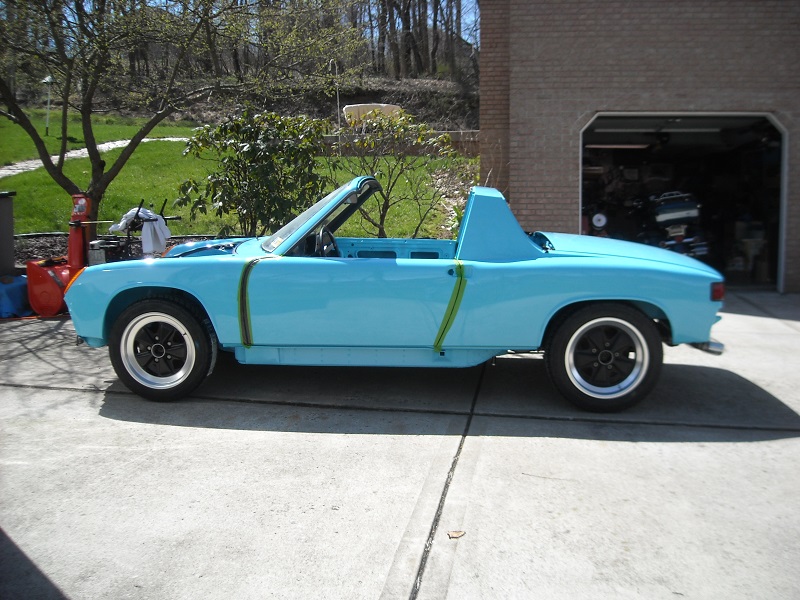

Olympic 1.7   Moved it outside for some pictures. paint turned o...   Aug 23 2016, 08:01 PM
914forme   It is really great to empty out some boxes and ...   Aug 24 2016, 12:25 PM
jkb944t   Moved it outside for some pictures. paint turned ...   Aug 26 2016, 10:48 AM
DirtyCossack   I imagine I'm not the only one sitting here on...   Aug 26 2016, 07:59 PM
Valy   Looking very good! Great job with the paint...   Aug 26 2016, 10:11 PM
