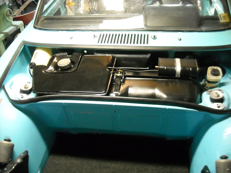

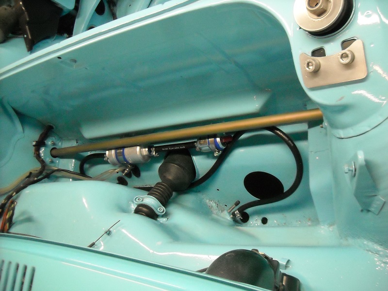

With the airbox in place now I can work on the gas tank stuff.
I had already installed the fuel pump, moving it to the front. its a tight fit with the front sway bar but everything clears nicely
the gas tank was pretty clean inside with just a little rust at the very bottom and when scraping this I uncovered a couple pin holes. so after having this professionally repaired at a local Tank Renew place and pressure tested it was ready for a coat of paint and install.

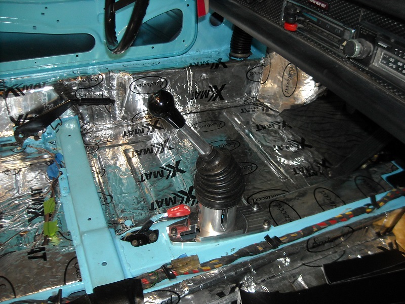

With the fuel taken care of it was time to move on to shifting.
next up was the installation of this beautiful piece .
Jwest Rennshifter.
I think I have it adjusted correctly but won't really know until I try to move it under its own power.
That day is coming soon.

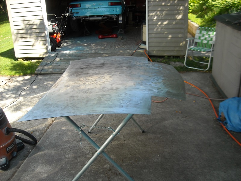

Still have a couple things left to paint and the front hood is the largest of these. also need to paint the headlight doors and the eyebrows.
Since the hood still had the 30+ year old acrylic lacquer paint job on it I decided to strip it totally down and start from scratch. It looks good but I can feel some imperfections that will need to be leveled out.
when cleaning up the underside I used my sandblaster and sand just KEPT ON coming out from under the ribs on the bottom.
using a combination of air pressure and vacuum I managed to get most of it out, but I still find a couple pieces of black beauty creeping out.
