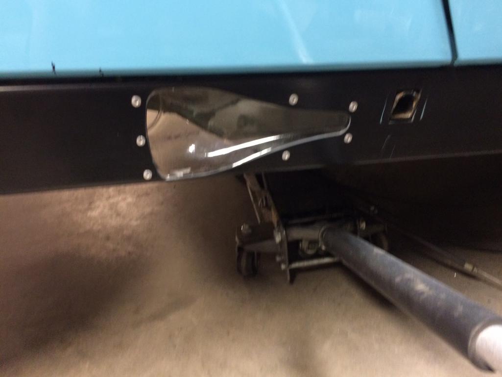

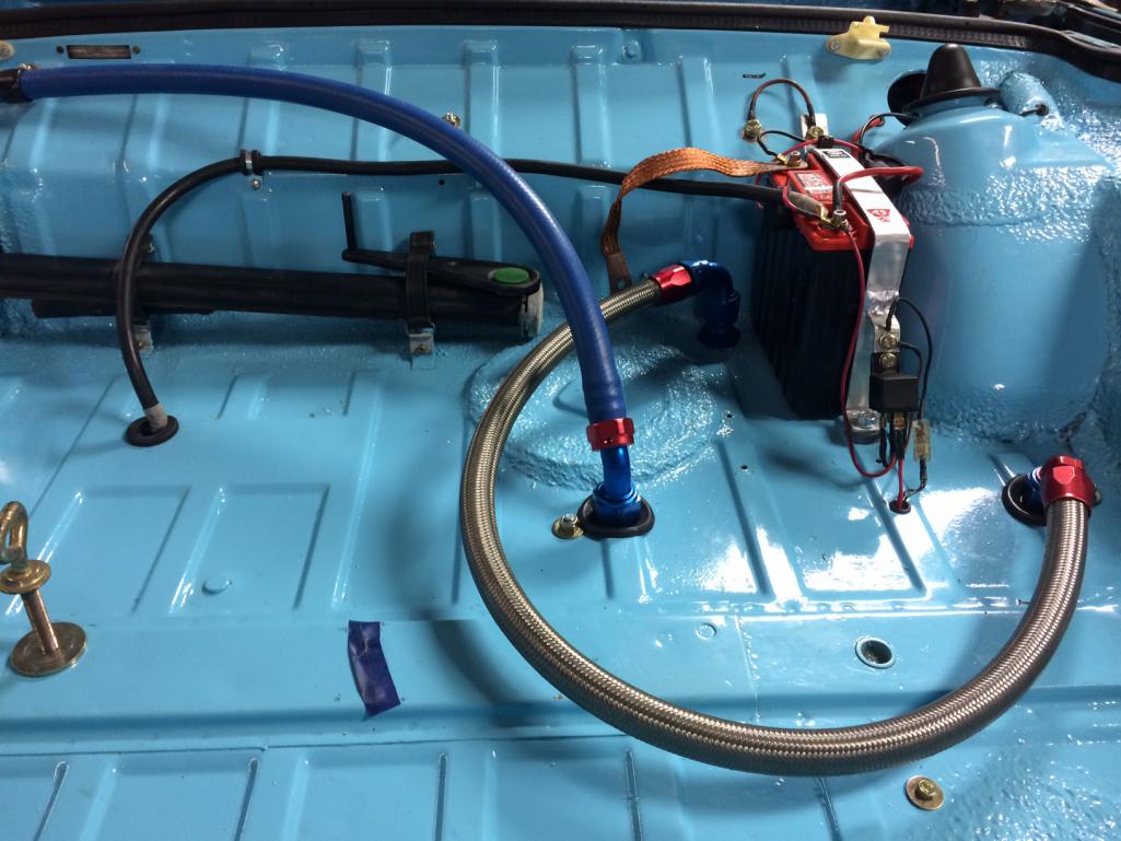

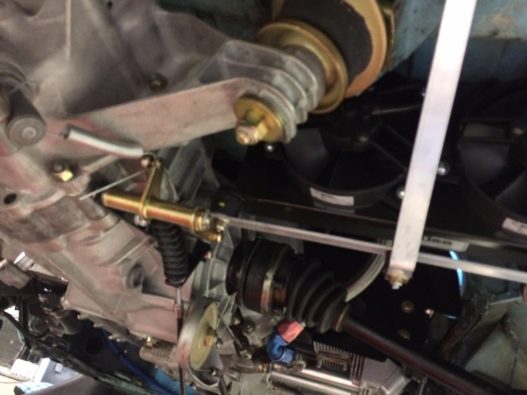

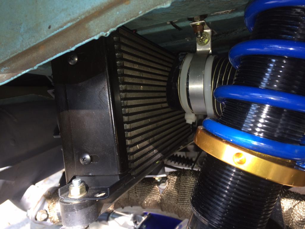

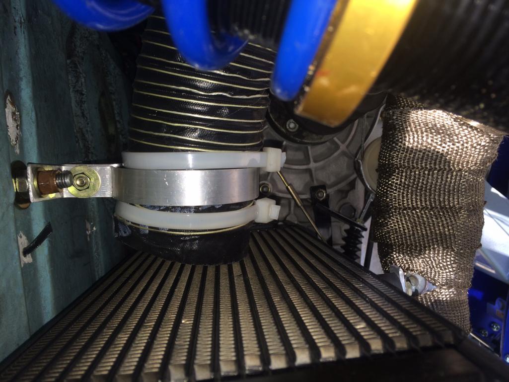

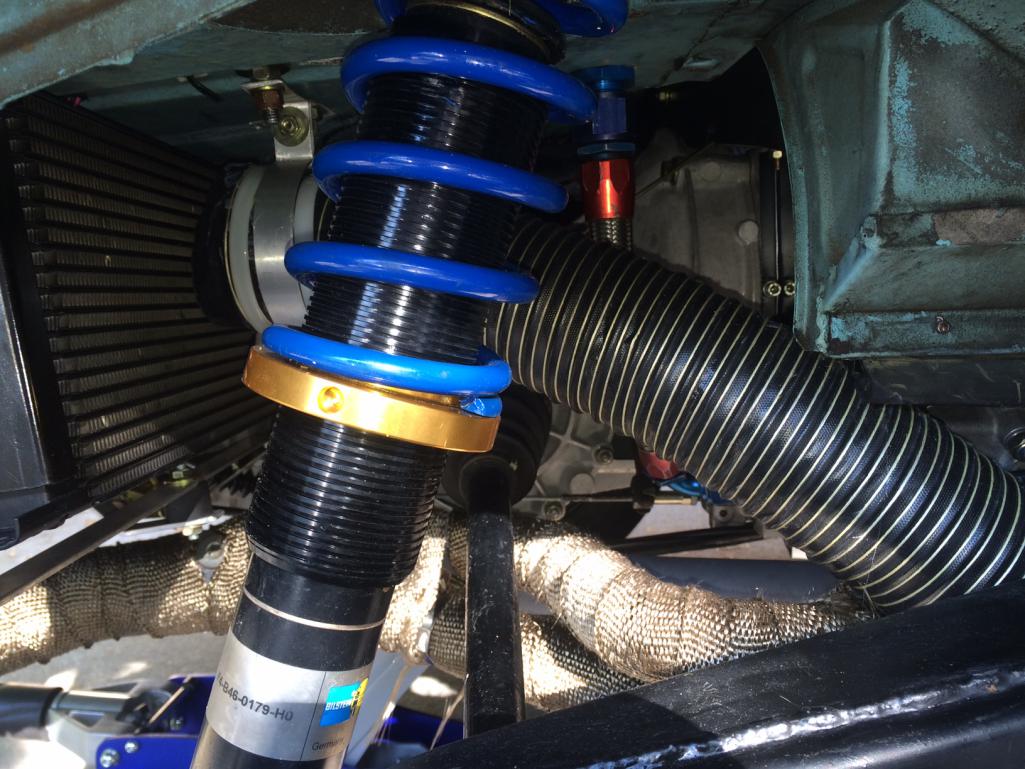

I used a Setrab FP920M22 IFeaturing a Setrab ProLine 9-series 20-row cooler (p/n 50-920-7612) and two low-profile 342cfm sealed-motor Spal fans, this unit performs sitting still as if mounted in the direct airflow at 50mph. http://setrabusa.com/products/fanpacks/fp920m22i/index.html
In the rear passenger. We elected to run the fans on a separate switch rather than a heat sensor. The car has never run more than half way up the gauge (911 with no numbers, I added the Naca duct and ran hose directly to the cooler. Its maiden trip was Dallas to Monterey with zero issues. Took it to Santa Fe NM the end of May with the same results.
