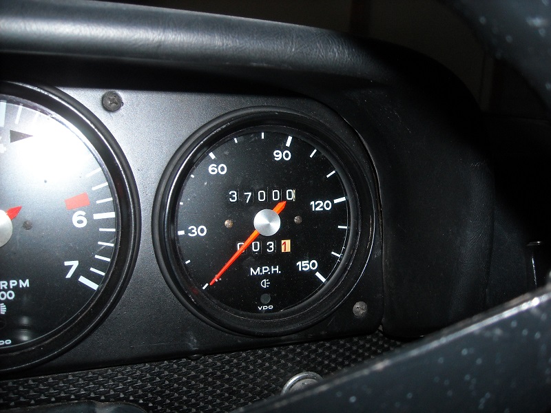

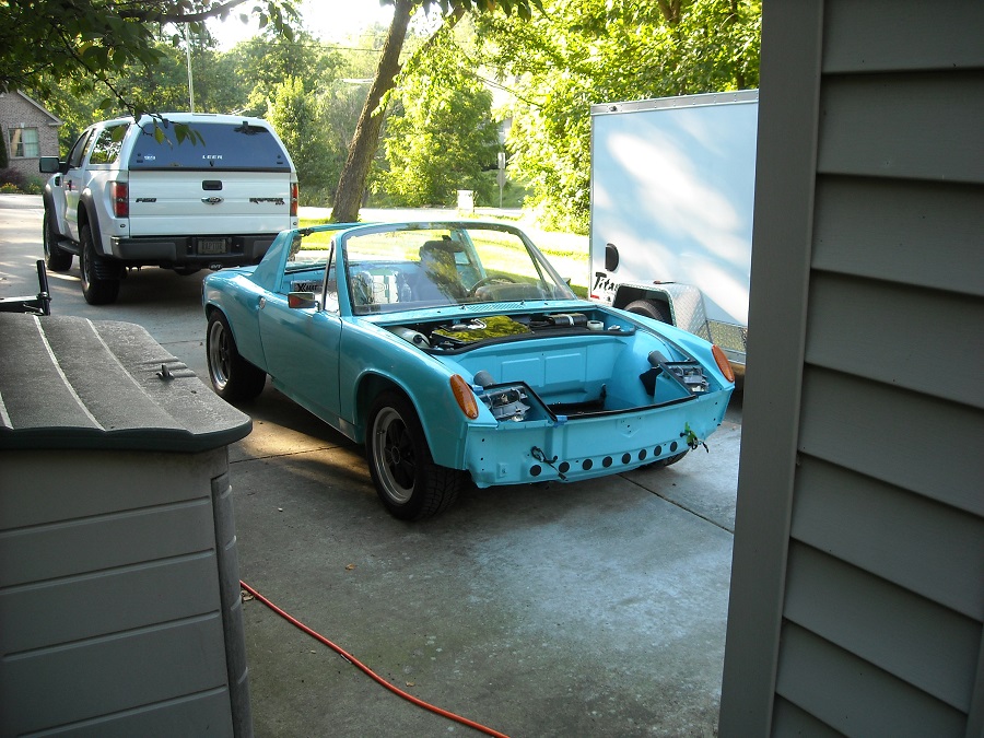

Drove the car yesterday. (IMG:style_emoticons/default/driving.gif)
First time it has moved under its own power for 27+ years.
After chasing a couple vacuum leaks that held the idle above 3000 and doing the cam break-in. I got the idle to settle down around 1100-1200 then after a little clutch adjustment I drove it up and down the driveway a few times. Then took it down the street, and when all went good ventured around the block. 3.1 miles
Finally getting past the 137,000 mile mark
No hood, bumpers, rocker panels, or valences installed and just the drivers seat bolted in, no carpets, door panels, etc. I have a lot to finish. all the window mechanisms are lubed and installed and work smoothly.
for the legal weenies out there, I do have new plates and insurance (they were in the trunk )
Unbelievably I seemed to have gotten the Rennshifter adjusted correctly the first time as I was easily able to shift. I don't think I took it past 3rd gear, there were too many things to try to monitor.
It was a momentous day.
