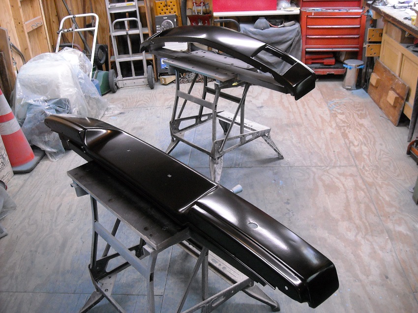

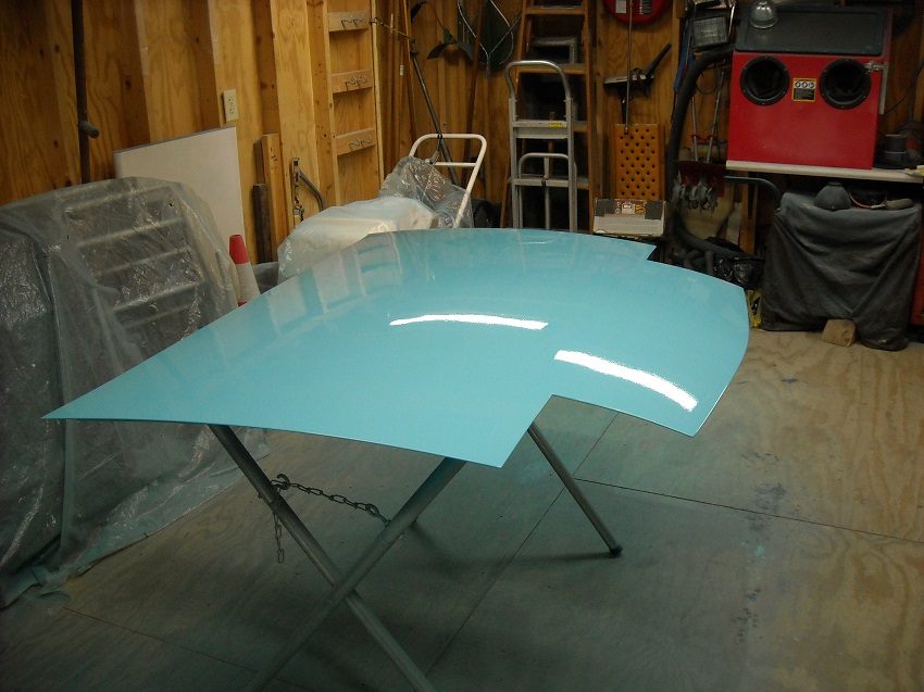

After blocking the hood, painted it along with the headlight doors and eyebrows.
Then did some work on the bumpers, I built a couple wooden frames to hold the bumpers while I worked on them, they clamped securely into the workmate stands it made it a lot easier hammering and sanding on them. The rear needed some massaging from being hit by a Lincoln years ago. Put paint on them also. Used SEM euro black trim paint. If I would do it again I would use the SPI black epoxy and add acetone to get the satin look. the good thing about the SEM paint is you can just buy another quart or spray can and it will still match. I will be using it on all the other trim pieces, and the rocker covers.
