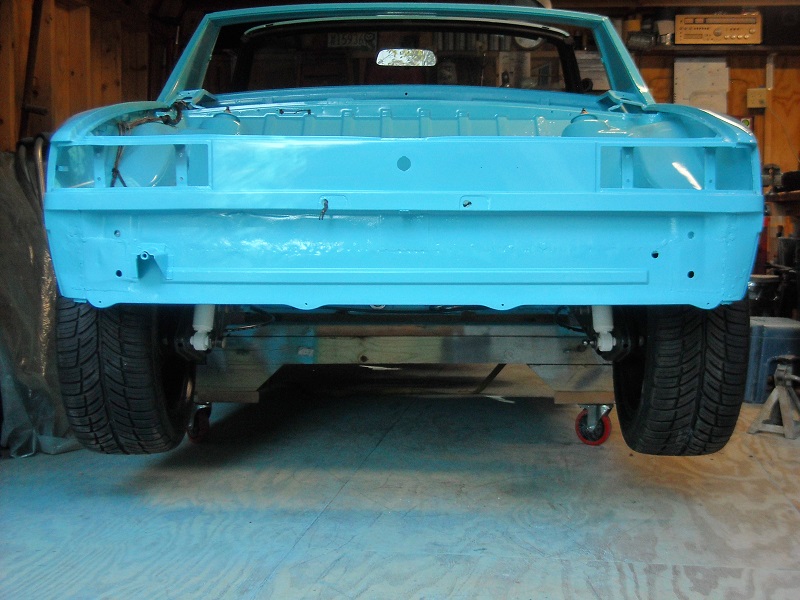

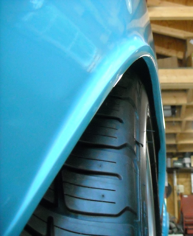

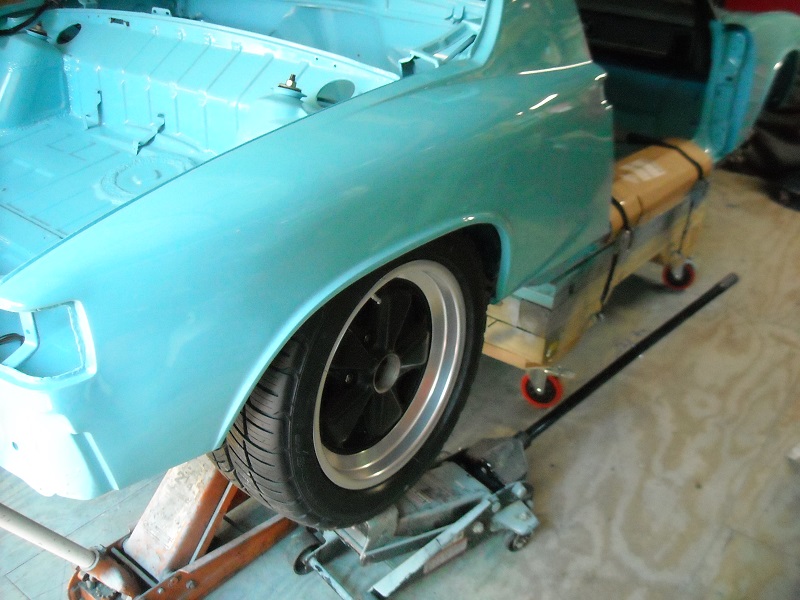

So I took a leap of faith and ordered the tires. BF Goodrich G-Force Comp 2
Fronts 205 50 16 on 7" rims
Rear 225 50 16 on 8" rims
QUOTE(Racer Chris @ Sep 20 2016, 09:46 AM) *
The 8s with 225s should fit fine.
And they do. (IMG:style_emoticons/default/mueba.gif)
Still need an alignment to see where they really end up, But looking good now.
So its OFF of the cart and finally gets to stand on its own four feet.
It starting to look like a car again.

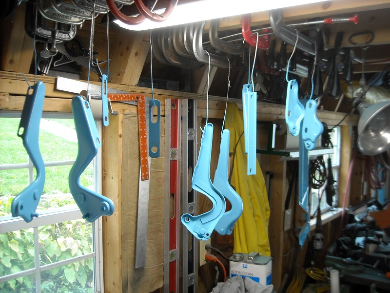

Just got the doors back from the blasters, So now I can start the bodywork on them.
Painted up the hinge hardware too. So I can mount the rear trunk lid, the front lid still needs paint. I will do that when I get the doors ready.

Racer Chris   The 8s with 225s should fit fine.   Sep 20 2016, 07:46 AM
Olympic 1.7   So I took a leap of faith and ordered the tires. B...   Oct 7 2016, 06:45 PM
3d914   So I took a leap of faith and ordered the tires. ...   Jun 17 2017, 03:28 PM
mbseto   Another little bit I spent too much time on.........   Sep 20 2016, 08:20 AM
Andyrew   Go to a tire store and ask them to mount a used 22...   Sep 20 2016, 09:55 AM
Andyrew   Quick note. You CAN mount 205's on 8's if ...   Sep 20 2016, 09:57 AM
