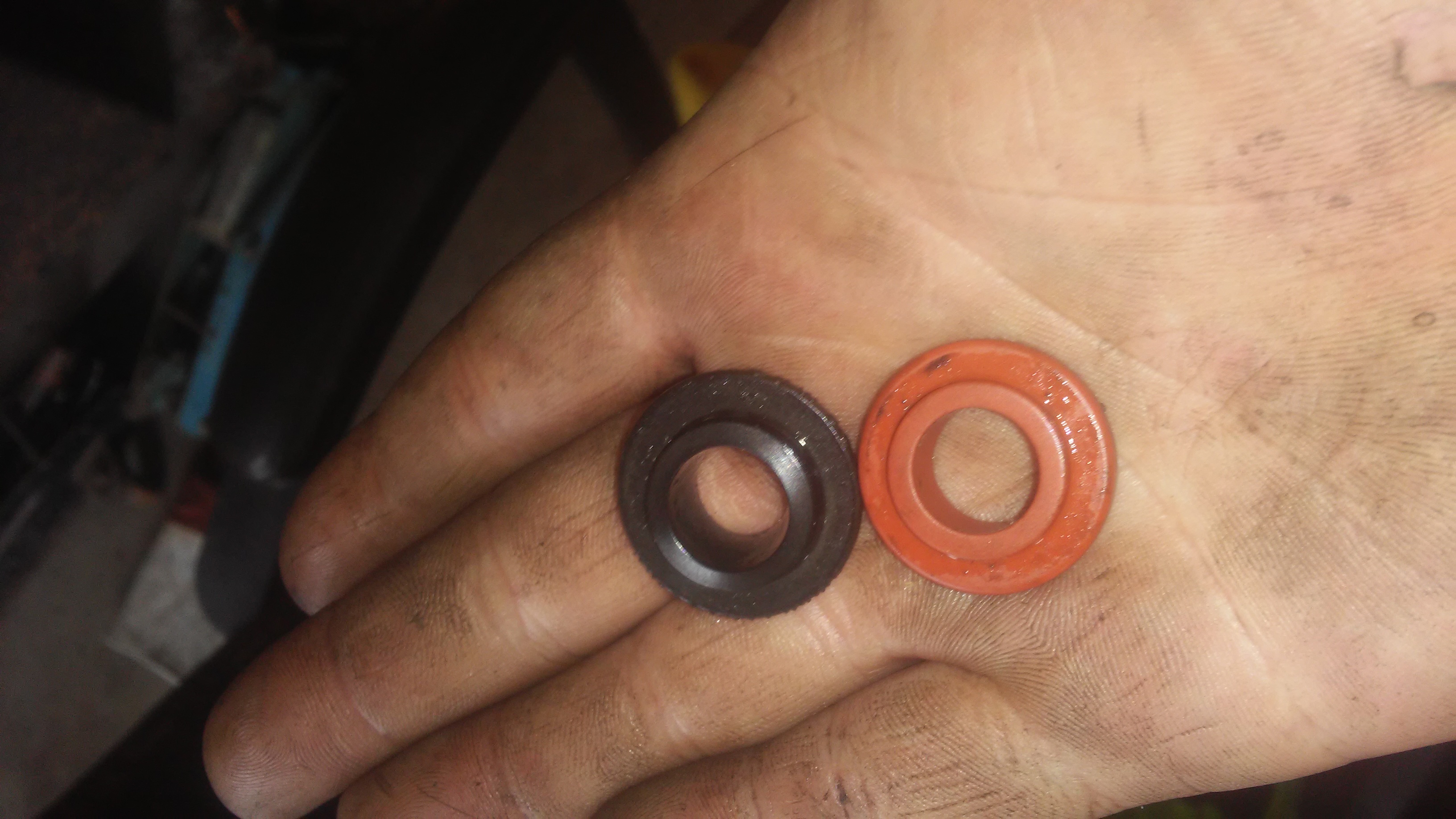

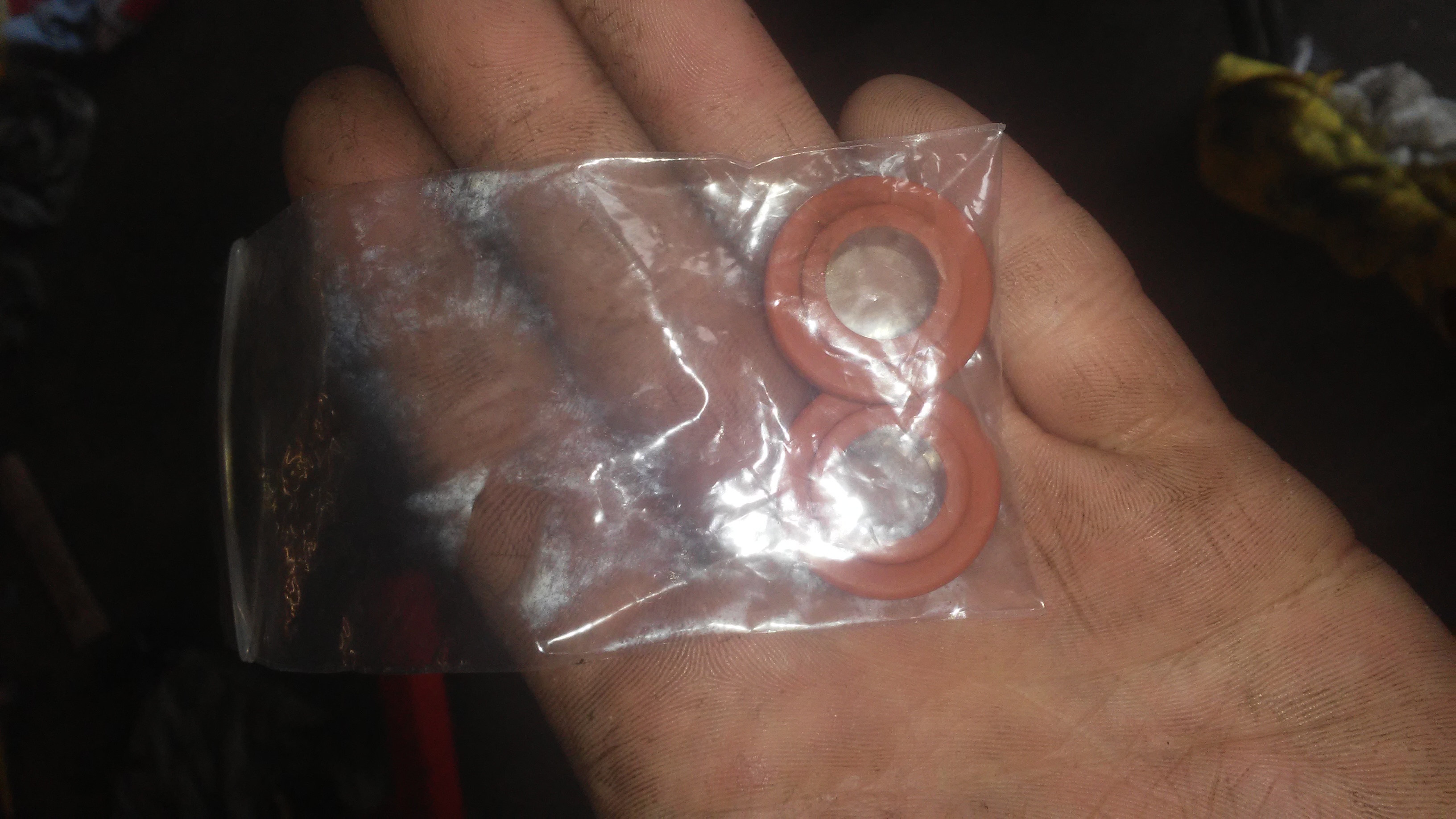

Back at it cutting out the rust and drilling spot welds. Also took some time to clean up the engine and replaced the leaky oil cooler seals with new ones from 914 Rubber.Attached Image Attached Image
