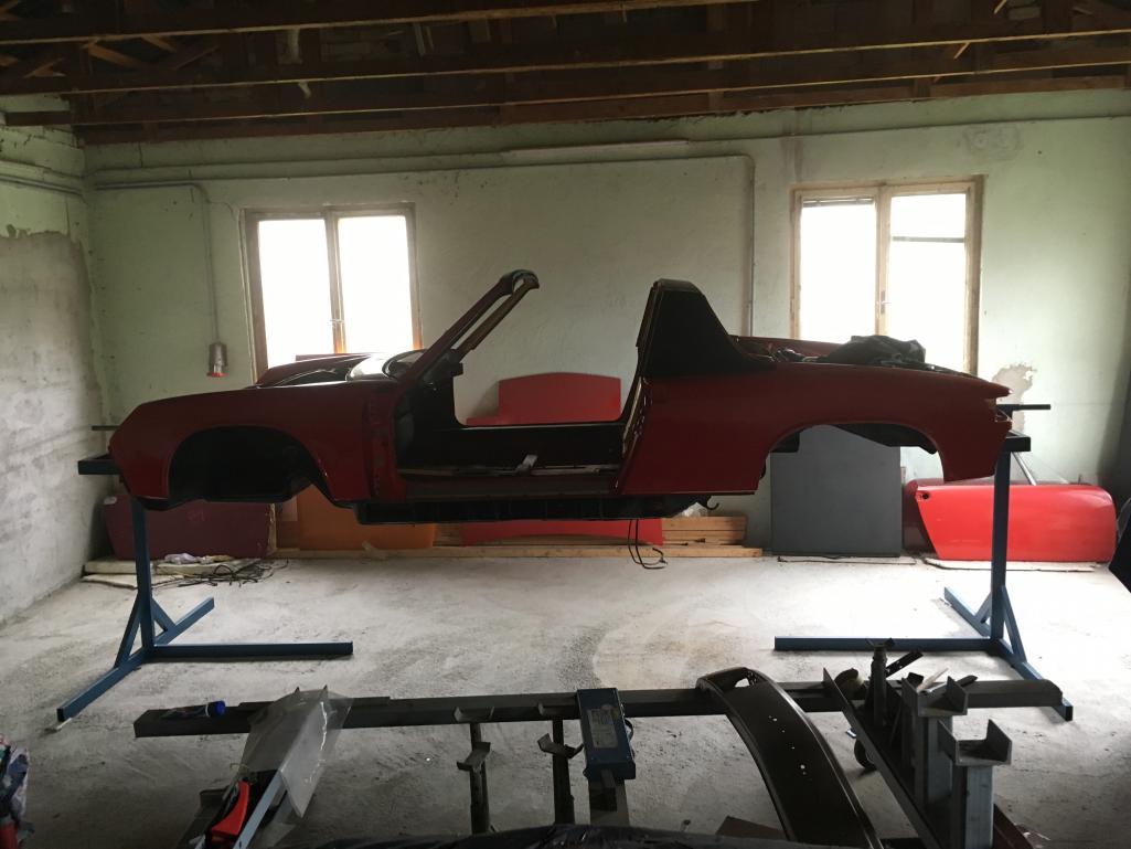

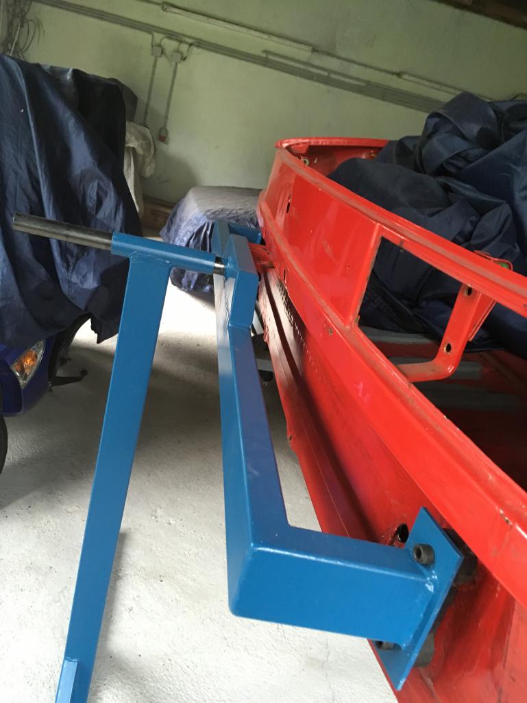

After many months I can continue working on my 914-6. Next step I already finished, Rotisserie is ready for use and dirt can be reomoved.

914Gelb   After many months I can continue working on my 914...   Jun 21 2017, 04:42 AM
914Gelb   RE: Any idea how to solve bad door clearence   Jun 21 2017, 04:45 AM
