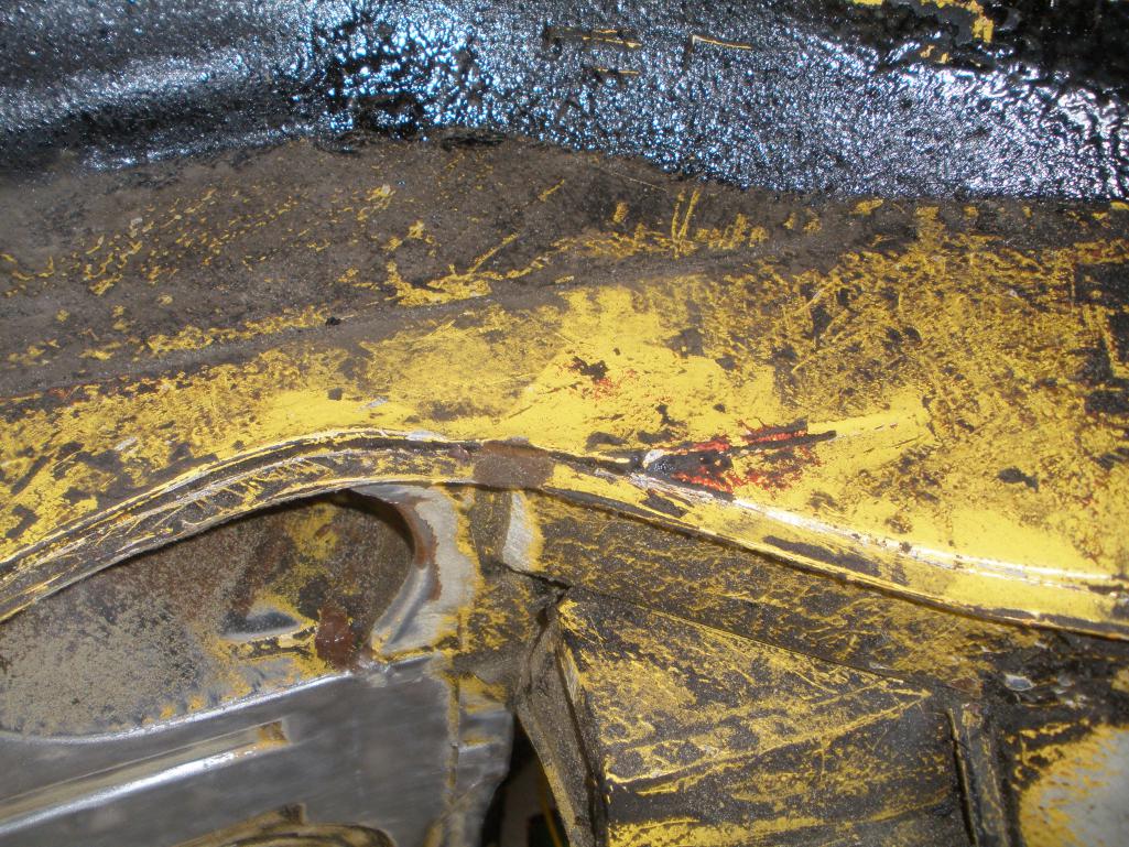

Here I found a small kink in the metal, 1st I was thinking car had accident in the back. I found no more hints, I don't know why this can happen.Attached Image

914Gelb   Here I found a small kink in the metal, 1st I was ...   Jun 21 2017, 04:59 AM

914Gelb   no this is not the demage I mean see the picture I...   Jun 21 2017, 06:49 AM
bretth   Maybe a previous owner was trying to improve tire ...   Jun 21 2017, 07:46 AM
