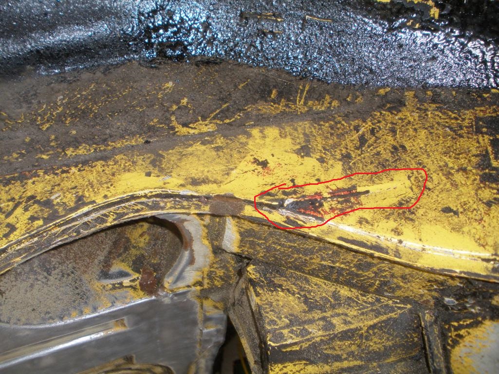

The damage you asked about (I circled it in red) and if this is the area that you're referring to that's not damage. That's a factory bend in the inner fender .

914Gelb   Here I found a small kink in the metal, 1st I was ...   Jun 21 2017, 04:59 AM

914Gelb   no this is not the demage I mean see the picture I...   Jun 21 2017, 06:49 AM
