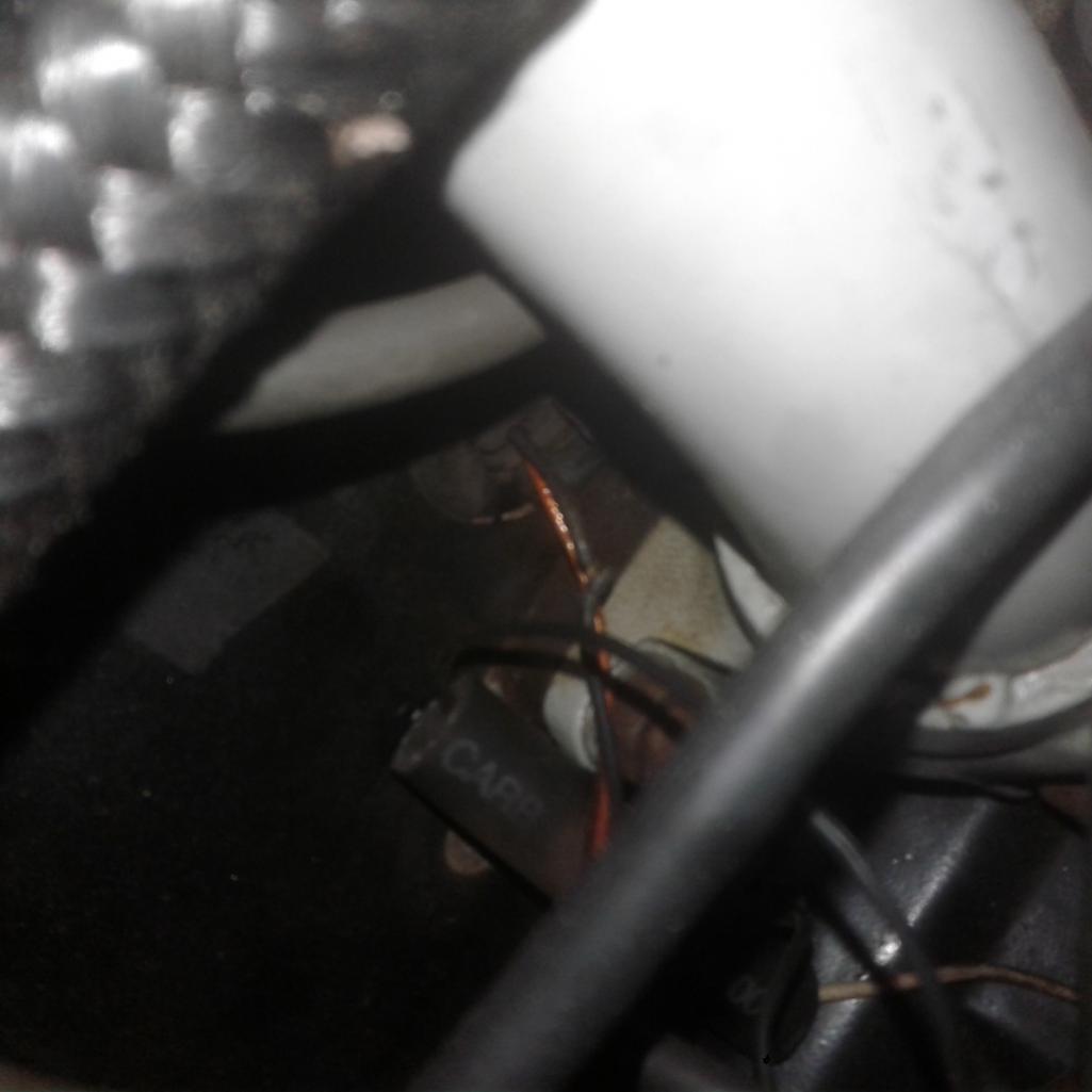

I'd like to put a CHT (Aircraft Spruce, most likely) on my engine, but it seems the spark plug location requires either some grinding of metal, which requires removing a bunch of stuff, that requires removing the engine, etc...
Is there another place to install a CHT? There is a CHT sensor on the engine, but doesn't that have to stay? Or, can I attach a gauge to that one? The only alternative I was able to find was this thread (thanks 76-914) about bending the wire 90 degrees on the spark plug install option: "Like Mark said it's just a piece of metal so open it up a bit so that the plug rotates freely in the ring. Then with the ring on the plug bend it 90 degress. Now turn the plug again to be sure that it rotates freely after the bend. Insert plug into #3 with the wire at the 9 o'clock position (or towards the rear) and tighten. There seems to be a bit more room for the lead when installed in this position. at least my head had a bit more room to the left side of the plug. BTW, I left the plug washer on so I would not twist the sender." |

Rand cylinder 3.
No reason to question it. Jun 22 2017, 04:53 PM
Mark Henry Under the plug or it's a useless reading. Jun 22 2017, 04:57 PM
914 RZ-1 So bending the piece that goes around the sparkplu... Jun 22 2017, 05:01 PM
michael7810
So bending the piece that goes around the sparkpl... Jun 22 2017, 05:41 PM
914 RZ-1 Thnx for the tip. I was hoping to avoid hogging ou... Jun 22 2017, 05:44 PM
michael7810
Thnx for the tip. I was hoping to avoid hogging o... Jun 23 2017, 06:21 AM
barefoot The proper relief for an under the plug TC:
Jun 23 2017, 07:04 AM
maf914 Barefoot,
Thank you for the helpful photos. This... Jun 23 2017, 07:14 AM
barefoot
Barefoot,
Thank you for the helpful photos. Thi... Jun 23 2017, 05:50 PM
Mark Henry You don't have to make the grove that big, I c... Jun 23 2017, 03:49 PM![]() ![]() |
