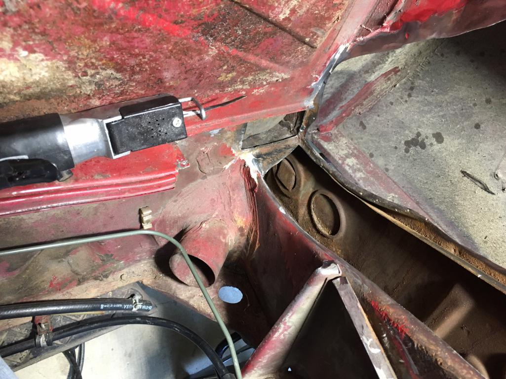

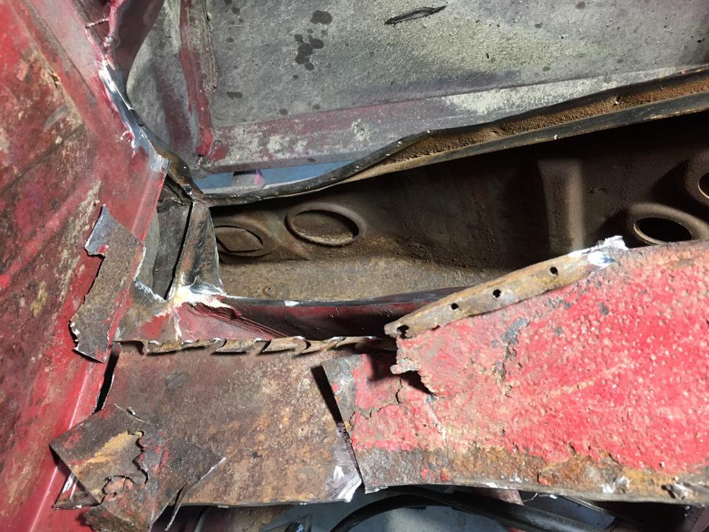

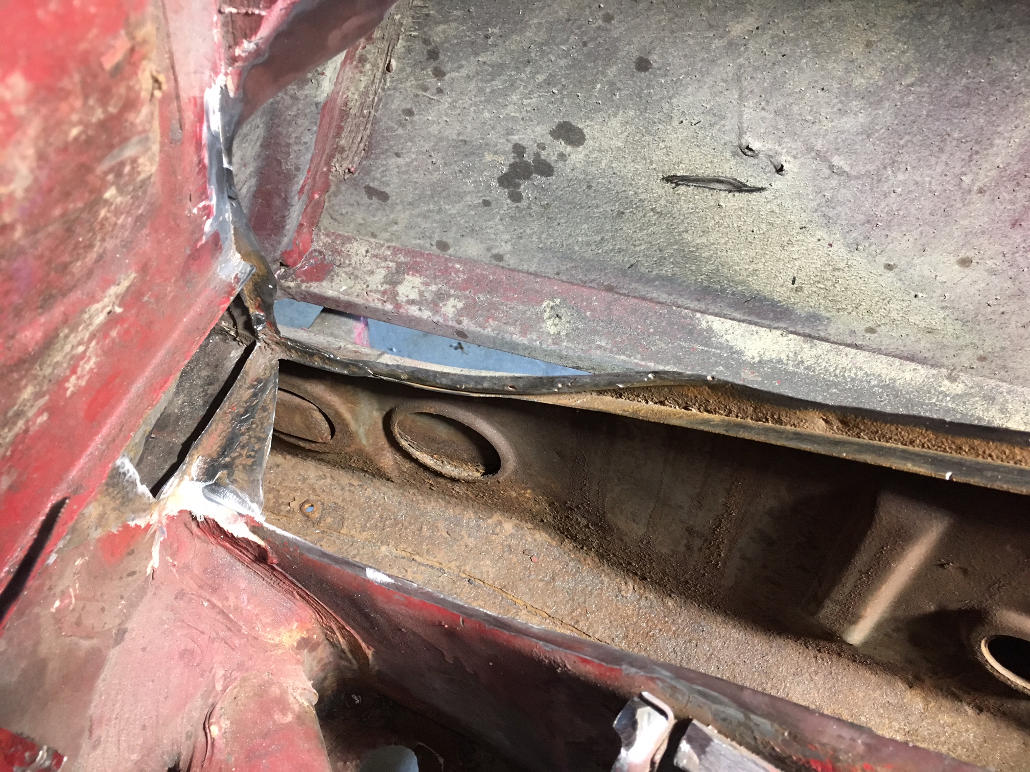

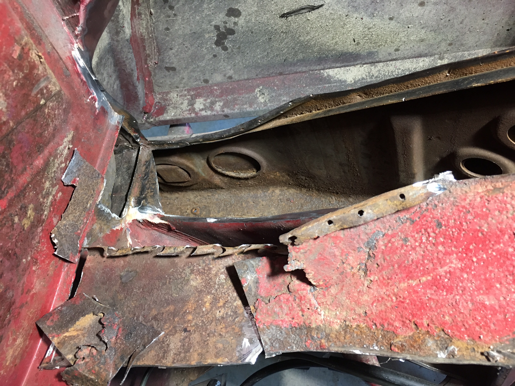

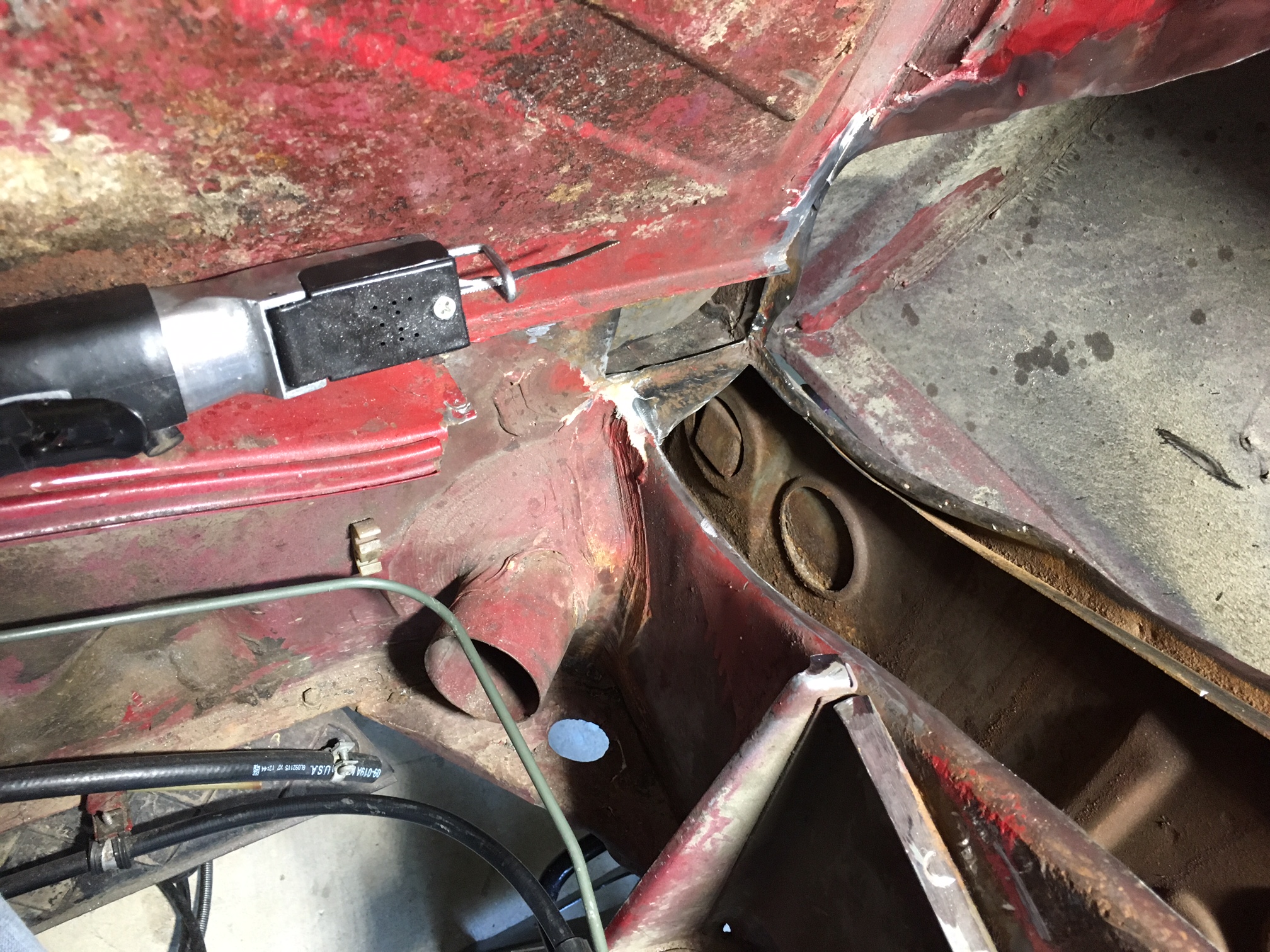

Cut out the sheet metal. I was using a cutting wheel at the beginning, half way through I discovered the high speed cutter at Harbor Freight which is much faster for making long cuts.
