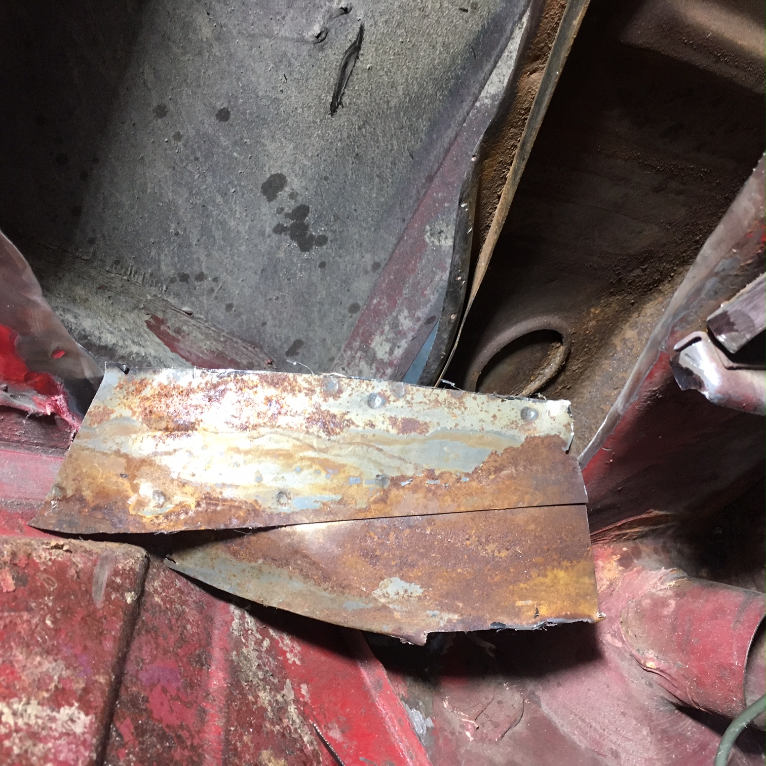

I also discovered there are 2 layers of sheet metal under the battery.

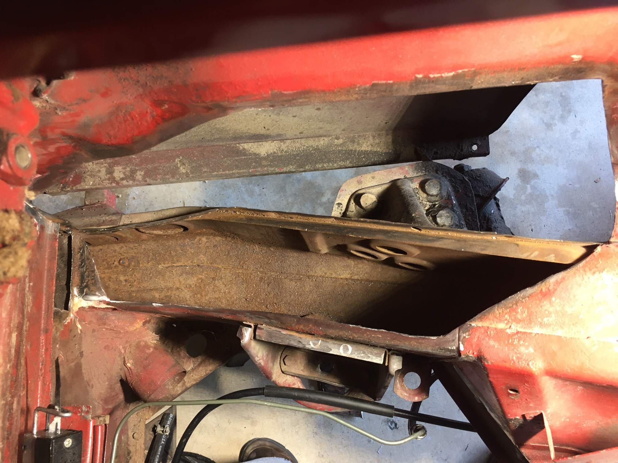

mtndawg   Cut out the battery tray and stand today. Someone ...   Mar 8 2017, 09:51 PM
mtndawg   Cut out the sheet metal. I was using a cutting whe...   Jun 23 2017, 06:28 PM
mtndawg   I also discovered there are 2 layers of sheet meta...   Jun 23 2017, 06:31 PM

mtndawg   Battery stand, tray and everything underneath fixe...   Apr 5 2018, 05:58 PM
