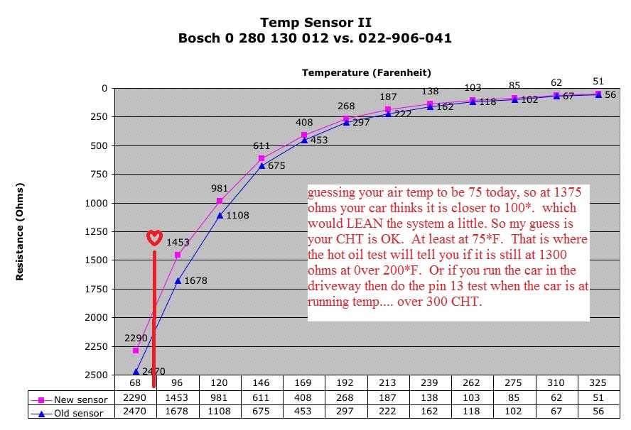

Clark, I got 1.376k ohms when pin 13 was connected to neg battery post.

QUOTE(brooks944 @ Jun 28 2017, 01:43 PM) *
Tim tells me that the CHT probably would not fail on one end of the graph and not on the other. But since we have a graph, I might do the 13th pin test after a long idle to heat up the cylinder head (key off of course), just for proof.... (IMG:style_emoticons/default/piratenanner.gif) (IMG:style_emoticons/default/piratenanner.gif)
So did you change the ECU.... if you did, which year did you install?
Do you have a way to test the fuel pressure?

brooks944   Clark, I got 1.376k ohms when pin 13 was connected...   Jun 28 2017, 12:43 PM
malcolm2   Clark, I got 1.376k ohms when pin 13 was connecte...   Jun 28 2017, 02:29 PM
